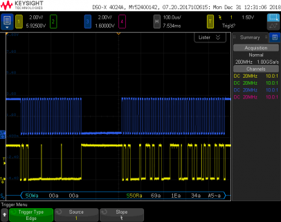

I tested Wire with the MB85RC256 chip. Seems to work fine. On this test, I used 1K pullup resistors. Here's the waveforms I see.
The code I posted yesterday for the 24LC02B chip requires a slight edit, since this larger chip uses 16 bit address for 32 kbytes of FRAM. The 24LC02B has only 256 bytes, so it uses 1 byte for the internal address field.
Here's the modified code I used with MB85RC256.
Thanks Paul. Before crashing (my sleep) I ran the adafruit lib sketch on using 4.7k with the MB85RC256. Looking at output it looked like it was working writing and reading to the registers. I didn't scope though. Going to test it with 1k and no pullups as well. Then back to the bme280 sensor.
Even with the 4.7k pullups the i2cscanner still did not work - have to check to see what error code is returning. Right now it the scanner tests if 0 is returned.
