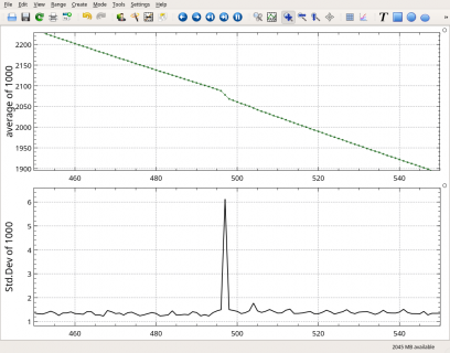

ADC input question: is "keeper" GPIO enabled?
Just accepted my invite to the T4 Beta1 testers and got the hardware; thanks Paul & Robin!
I tried measuring a slowly changing voltage using the ADC A0 input. My voltage source was 4300 uF of capacitance charged to 3.3V and then slowing discharging through R=11k to ground. Using 12-bit ADC mode, my code averages together 1000 readings and I also set analogReadAveraging(16). I print out the average and standard deviation for each set of 1000. My code is here: https://github.com/jbeale1/DataAcq/blob/master/TeensyADCTest.ino
Everything worked as expected, except there is one small jump (differential nonlinearity) that is near, but not quite at the midpoint. In the enclosed graph, at sample count 497 the standard deviation of that set of 1000 samples jumped to 6 when all others are near 1.5, and you can see a step-offset around count 2078 in the average value as it slopes down. The exact midpoint would be count 2048 which in this experiment comes 5 samples later, so the jump is not precisely at midpoint.
I noticed this note in the IMXRT1050 Reference Manual, p.3141 :
NOTE The ADC input signals connect to GPIO[0:9]. The GPIO default configuration is enabled for keeper. The keeper causes an undesired jump behavior in ADC. To avoid the problem, disable keeper before starting ADC. For detailed information about keeper, refer to the GPIO block.
https://www.nxp.com/docs/en/reference-manual/IMXRT1050RM.pdf
I wonder if this could be related? Apart from that one jump the rest of the transfer curve looks smooth, and the ADC has enough noise that averaging together 1000 samples gets you better than 1 LSB of resolution. (Some ADCs get "stuck" on each value, so averaging together many samples still shows 1-LSB steps on a slow ramp, but that's not the case here.)
regards, john

Not 100% sure that keeper is on by default, To check you can do a Serial.println(CORE_PIN14_PADCONFIG, BIN) and bounce it against the IOMUXC_SW_PAD_CTL_PAD_GPIO_AD_B1_02 register in the RM. About ready to crash for the night so I can check in the morning. As to what is causing the bleep I have to leave that to others to answer.
Regards
Mike

I checked this morning and it looks like keeper is enabled by default. But whats interesting is that you only see it once. To disable in setup is relatively easy:
IOMUXC_SW_PAD_CTL_PAD_GPIO_AD_B1_02 = 0xb0;
This of course is just for A0.
Yes! Thank you, I can confirm that adding this line to my setup removed the glitch around count 2078 that I found earlier. Now when you look at the standard deviation along the curve you see only the typical successive-approximation type fingerprint of the MSB transition at 2048 plus the comb pattern of the next few bits down, but they are smaller. Next question: how to deal with this somewhat obscure "feature" which is unlike other Teensy or Aduino parts I'm familiar with? Not clear if the keeper should be disabled by default, as it is useful to keep power dissipation down when A0 is unconnected or on a high impedance node, and the ADC glitch is subtle enough that many people might not realize it's there unless they test carefully.
