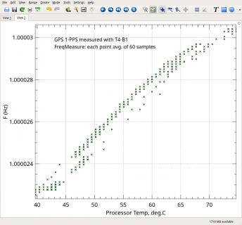

frequency offset vs. CPU temperature
@mjs513 I don't know the best way to implement turning off the keeper. I think the default should be no keeper when a pin is used as analog input. I suppose there might be cases where you might want it on even when using the ADC but it would be the exception.
For what it's worth, my sample of the T4-beta1 running FreqMeasure on a GPS 1-PPS signal reads around 1.000024 Hz near room temperature, and the indicated frequency goes up with reported CPU temperature. I presume that means the crystal on this particular board is 24 ppm slow, and also it becomes slower with rising temperature.
This plot shows a day's worth of data as I slowly change the temperature of the board. It's nice that we can print out the internal CPU temp. Each point is the average of 60 frequency readings (eg one point per minute). There is a bit of a hysteresis loop; the lower points are going up in temperature and higher points are coming down. This was a very casual test, not in a precisely controlled oven. I had the board in a box, starting at room temperature, then put it on a warm brick. At intervals I switched in a warmer brick. Then I let it cool back down.
/* FreqMeasure  http://www.pjrc.com/teensy/td_libs_FreqMeasure.html */
#include <FreqMeasure.h>
const int LED1 = 13;         // output LED connected on Arduino digital pin 13
  Serial.begin(115200);       // baud rate is ignored with Teensy USB i/o
  digitalWrite(LED1,HIGH);
  delay(1000);                // LED on for 1 second
  digitalWrite(LED1,LOW);
  Serial.println("FreqMeasure starting...");
  FreqMeasure.begin();
double sum=0;
int count=0;
  if (FreqMeasure.available()) {
    sum = sum + FreqMeasure.read();
    count = count + 1;
    if (count >= 60) {
      float frequency = FreqMeasure.countToFrequency(sum / count);
      Serial.print(frequency,8);
      Serial.print(", ");
      Serial.print(tempmonGetTemp(),1);
      sum = 0;
      count = 0;
@JBeale and others
