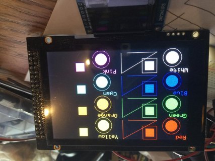

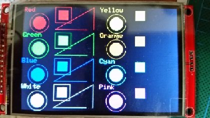

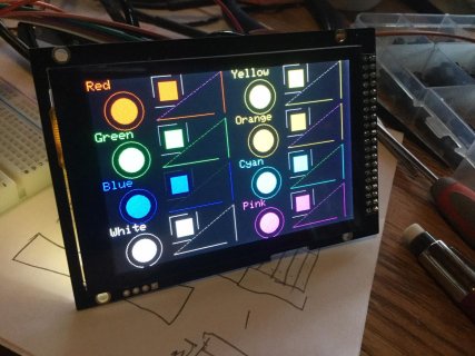

ili9488 working on T4 and T_3.6 (FB_teensy36 / C64) !!
ODD on T_3.6: Compiled at 180 MHz the graphicstest.ino completes faster than when set to 256 MHz? [sum us shows below]
Running :: ...\libraries\ILI9488_t3\examples\graphicstest\graphicstest.ino
As @mjs513 noted the first Groop test is flipped.
@mjs513:: Did you post 9488 BhudaBrot? … <edit> FOUND IT post 2186
@mjs513:: On the C64 I left the ili9341 in place on first upload and it worked as before - the 9488 code colors are wrong but the out of range drawing is ignored and it shows the connections are right.
Then I swapped on the 9488 having Made these adds to get C64. And for T4 had RST on #23 so that had to be included as below.

Good Morning again...
First on colors, looks like there may be some issues with non horizontal/vertical lines... To debug...
Here is a quick and dirty test program to show colors...
#include <ILI9488_t3.h>
#define TFT_RST 8
#define TFT_DC 10
#define TFT_CS 9
ILI9488_t3 tft = ILI9488_t3(TFT_CS, TFT_DC, TFT_RST);
// Setup
  tft.begin();
  tft.setRotation(3); // 180
  delay(100);
  tft.fillScreen(ILI9488_BLACK);
  delay(250);
  tft.fillScreen(ILI9488_RED);
  delay(250);
  tft.fillScreen(ILI9488_BLUE);
  delay(250);
  tft.fillScreen(ILI9488_GREEN);
  delay(250);
  drawColor(0, 0, "Red", ILI9488_RED);
  drawColor(0, 80, "Green", ILI9488_GREEN);
  drawColor(0, 160, "Blue", ILI9488_BLUE);
  drawColor(0, 240, "White", ILI9488_WHITE);
  drawColor(240, 0, "Yellow", ILI9488_YELLOW);
  drawColor(240, 80, "Orange", ILI9488_ORANGE);
  drawColor(240, 160, "Cyan", ILI9488_CYAN);
  drawColor(240, 240, "Pink", ILI9488_PINK);
void drawColor(uint16_t x, uint16_t y, const char *psz, uint16_t color)
  tft.setTextColor(color);
  tft.setTextSize(2);
  tft.setCursor(x,y);
  tft.print(psz);
  tft.fillRect(x+100, y, 50, 50, color);
  tft.drawLine(x+100, y+70,x+200, y+70, color);
  tft.drawLine(x+220, y, x+220, y+70, color);
  tft.drawLine(x+100, y+70, x+220, y, color);
  tft.drawCircle(x+50, y+50, 30, color);
  tft.fillCircle(x+50, y+50, 20, color);
// Loop
More graphic functions can be added... to see what loos like it might fail to do right colors... Like gradient stuff...

That is I shrank the fill rect and added drawRect and the drawRect looks screwed up.
Update: Fixed some of the color issues, HLine, VLine, Pixel were not converted to use the Write16BitColor...
Those functions now in my header look like:
	void HLine(int16_t x, int16_t y, int16_t w, uint16_t color)
	  __attribute__((always_inline)) {
	  	if((x >= _width) || (y >= _height) || (y < 0)) return;
		if(x < 0) {	w += x; x = 0; 	}
		if((x+w-1) >= _width)  w = _width-x;
		setAddr(x, y, x+w-1, y);
		writecommand_cont(ILI9488_RAMWR);
		while (w > 1) {
			write16BitColor(color);
		 	w--;
		write16BitColor(color, true);
	void VLine(int16_t x, int16_t y, int16_t h, uint16_t color)
		if((x >= _width) || (x < 0) || (y >= _height)) return;
		if(y < 0) {	h += y; y = 0; 	}
		if((y+h-1) >= _height) h = _height-y;
		setAddr(x, y, x, y+h-1);
		while (h > 1) {
		 	h--;
	void Pixel(int16_t x, int16_t y, uint16_t color)
		if((x >= _width) || (x < 0) || (y >= _height) || (y < 0)) return;
		setAddr(x, y, x, y);
Picture looks correct now...
GraphicTest appears to show more of the right colors now...
But I also saw some stuff, that was interesting. In that I ran my display app, then downloaded graphic test and it started off, by doing a bunch of the tests only using a portion of the display. Almost like the init code was setup maybe for ili9341 so only output 320x240...

@defragster - thanks will have to give it a go in a bit. Trying to get everything incorporated into the new lib.
@KurtE
Played a bit more and this is what I have not. Can't tell where the problem is though.
@mjs513 @defragster,
I downloaded the github library :D So far I just cloned it down and have not forked it yet. Not sure if should just update changes or would you like fork with PR?
I updated the HLine/VLine functions to closer match my later changes where hopefully the last pixel is output with _last...
I ran my updated test program:
#define TFT_RST 8
#define TFT_DC 10
#define TFT_CS 9
// Setup
  tft.begin();
  delay(100);
  delay(250);
  delay(250);
  delay(250);
  delay(250);
  tft.setTextSize(2);
  tft.setCursor(x,y);
  tft.print(psz);
  tft.drawRect(x+100, y, 50, 50, color);
  tft.fillRect(x+110, y+10, 30, 30, color);
// Loop
And get right colors... BUT! not everything is showing up?
That is:
That is if you look the colors on right side of display, the drawRect is now showing up, the circle is being clipped and the other lines are not showing up...
suspicion is added clip rectangle and maybe setup by default to ILI9341 display size...
@KurtE
the problem was in the setRotation function, it needed these two lines:
	setClipRect();
	setOrigin();
so the whole function looks like this:
void ILI9488_t3::setRotation(uint8_t m)
	rotation = m % 4; // can't be higher than 3
	beginSPITransaction();
	writecommand_cont(ILI9488_MADCTL);
	switch (rotation) {
	case 0:
		writedata8_last(MADCTL_MX | MADCTL_BGR);
		_width  = ILI9488_TFTWIDTH;
		_height = ILI9488_TFTHEIGHT;
	case 1:
		writedata8_last(MADCTL_MV | MADCTL_BGR);
		_width  = ILI9488_TFTHEIGHT;
		_height = ILI9488_TFTWIDTH;
	case 2:
		writedata8_last(MADCTL_MY | MADCTL_BGR);
	case 3:
		writedata8_last(MADCTL_MX | MADCTL_MY | MADCTL_MV | MADCTL_BGR);
	endSPITransaction();
	setClipRect();
	setOrigin();
	cursor_x = 0;
	cursor_y = 0;
Then it draws the whole thing :) Shoot I forgot to push the change. I'll do it now. ,,, ok change pushed.
If you want to go ahead and update hline and vline not a problem - don't need a pr.
By the way you need to change your one horizontal line to:
tft.drawLine(x+100, y+70,x+220, y+70, color);
then the triangle connects :)
