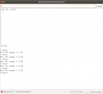

Weird results with the audio-shield.
with my patched file (attached) I get different results every time i disconnect-and reconnect usb-cable. Output should be all 1s.
I'll look into this I2C issue.

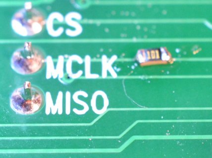

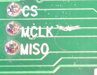

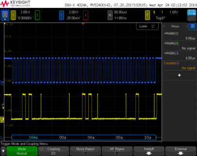

I'm continuing to look into the audio problems. It's really starting to look like a signal quality issue. Turns out the 1052 chip on beta1 has the exact same problem as 1062 on beta2 when I replace the 5 mux chips with wires.
I soldered another board just now, using 33 ohm resistors in place of the mux chips. It's drying in the oven now, will test with it in ~15 min.
Edit: beta1 audio works with the 33 ohm resistors...
would a capacitor MCLK to ground not also filter the signal?Unfortunately this appears to be the only way to get the audio shield to work with the beta #2.
