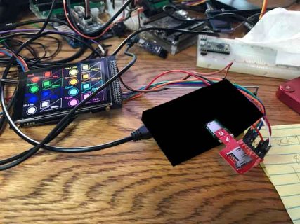

I just pushed up changes to my SPI branch: https://github.com/KurtE/SPI/tree/T4B2_SPI1_SPI2
I used my hacked up version of ILI9488 on SPI2 and my test app appears now to be working.
Hopefully I obscured the processor in picture enough ;)
Used Sparkfun SD breakout board... Somewhere around here I have some I made for T3.5/6 testing...

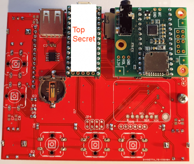

Got my own first T4B2 board today - good timing.
It has a Audioshield - had to insert a resitor to MCLK, too.
USB works on my board (with the TPS chip), have to test SD now.

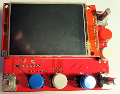

I think this red thingy keeps me busy testing the T4 for the next days:
- 3 Encoders
- 5 Buttons
- Display
- PJRC Audio board (had to add the MCLK resistor)
- USB-Host (with TPS-chip)
- SD-Slot
- RTC Battery Backup
- PCF8574 I2C Port Expander
- additional parts for a SDR
...as usual with a few issues and some wires hidden under the display .. :)

That is AWESOME Frank! Congratulations! Glad it worked first time … after good soldering :)
Is that an 8MB RAM by the USB port? - or the TPS chip ...
It is the TPS-Chip.
I've tested the 8MB RAM with th T3.6 only, so far.
I'll make little board for it, when i've figured out how to use quad-spi with flexio.
