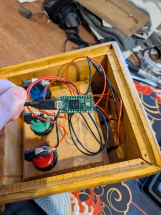

This is my first project with an IC, so I'm sure I am doing something obviously wrong.
I am using a Teensy 4.0 to control 3 WS2812 Addressable LEDs with arcade style buttons as inputs. I am using the integrated pulldown resistor to tell when the buttons are pressed. When a button is pressed, it's corresponding LED should toggle on. I intend to power this with a USB battery bank (current one is an AnkerCore Slim 10000).
My current issue is the circuit will occasionally freeze. I find that it constantly freezes when powered from a source other than my PC's USB port, but will occasionally freeze with enough rapid button presses. Sometimes it almost seems to "reset itself" and begins to work correctly again, while other times it just stays stuck.
Here are some videos of the device. Additionally, I've attached a wire diagram I made of the circuit, as well as a photo of my poor soldering job.

@alasor31: Welcome to the world of "you can make this processor do anything you want !!" For your particular application, I would recommend taking a look at using the BOUNCE library, as it will efficiently take care of handling any switch/button bounce for you. This should make managing your buttons much simpler, allowing you to fucus more on what happens when a button is actually pressed. <Here's> a previous post in which @PaulStoffregen discusses one example of its usage.
Hope that helps . . .
Mark J Culross
KD5RXT
Teensy 4.x pins are not 5v tolerant - your diagram shows that's what you've wired on the high side of the switches, which will fry your Teensy. You should stop using this circuit immediately to prevent permanently damaging it.
@kd5rxt-mark Thanks! That dramatically reduced the size of code, made it much more readable, and the problem of rapid button presses causing a freeze has been eliminated.
However, I still freeze while plugged into any other power source besides my computer.

Yikes, DO NOT wire the pushbuttons to +5V power!! Serious risk of damage to Teensy this way!
You should wire the pushbuttons to GND. The pins should use pinMode INPUT_PULLUP.
