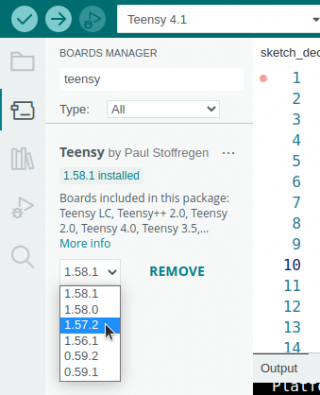

Looks like case of static init order messed up with the new gcc 11.3 toolchain not using const init for hardware serial.
Simple solution is to revert to Teensyduino 1.57, the last version to use the old gcc 5.4 toolchain. If using Arduino IDE 2, just use Boards Manager to install version 1.57.2.

Paul, thanks for you reply, I did as instructed, it no longer enters a reboot loop, but the code doesn't run. I put a coupe of debug statements in Setup(). It doesn't get that far.
