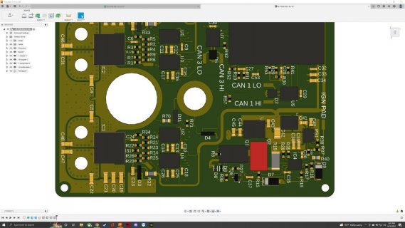

I'm developing a product for motorsport use. It is a power distribution module (I've posted about this this project before), It distributes high current 12v power to various loads on the vehicles. Also is controlled via CAN bus and can act as a gate way etc. etc.
I have already made boards using a teensy 4.0 board and tested the product. Works great. But now id like to integrate the extra i/o of the 4.1 and put the 1062 ic and Pauls boot loader chip directly on to the pcb. Will allow me more freedom during routing. I'm pretty much out of room and I now need to add analog and digital inputs, LIN bus etcetera.

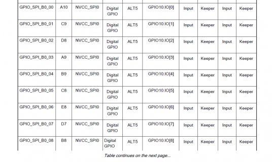

But there is an extra set of pins named "GPIO_SPI_B#_##", and "NVCC_SPI#", those make up 24 extra pads.

I don't know what "SPI" means in this case. I don't think its extra serial peripherals?.. This data sheet seems to be sort of an intro haha.. I'll look for a more in depth one.
Those are the only differences I see in pin names and numbers. same number of I/O and pin terminology otherwise.
I'll probably make a few prototype boards using this ic if i can figure out what these "SPI" pins are and what to do with them..

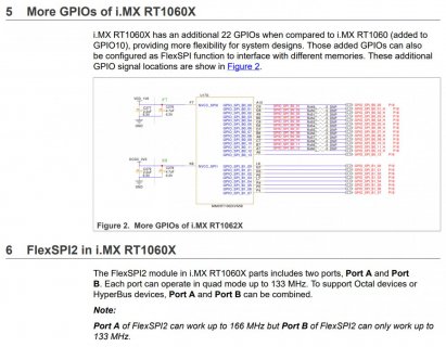

Found a document that explains the differences between 1060 and 1060X. I can't tell if its going to cause any issues though :confused:
The 1060 extended runs at a maximum of 528MHz instead of 600MHz. Which is already an option in the ide.
Also says that the 1060x added another dedicated flexSPI port. But I don't know if this will affect functioning as a teensy yet. Or if its possible to add the ability to use the i/o?

As long as the extra SPI hasn't impacted the internal memory map for the peripherals then it shouldn't matter. You won't be able to use it easily but the default state would be for it to do nothing so it not being easily accessible isn't an issue.
Also on the automotive side make sure your power supply can cope with a load dump condition. When you crank the engine you first brown own with the voltage dropping a lot that you need to keep running through and then when the starter shuts off you'll get a spike that can get into the couple of hundred volts. An off the shelf 12v supply without extra protection can very easily go pop when that hits it.
Kinda looks like NXP put the RT1064 chip into a package with more pins and brought out the signals which were connected to a separate flash die inside the same RT1064 package. I believe (but have zero actual evidence to back up my belief) that RT1062 and RT1064 are probably the same silicon internally, though they might have different ROM or other customization on the top metal layer.
I'd guess RT1060X has a 50-50 chance of working with the T4 bootloader chip, if you wire up one of the supported Winbond flash chips, and of course do all the other design properly for details like power supply start up sequence. But again, I haven't actually used this chip, so this guesswork comes with a pretty big caveat.
If you don't have an appetite for risk, going with one of the wide temperature range RT1062 chips that @ted confirmed work would be much safer. If you do experiment with RT1060X, I hope you'll share the results.

The bottom right hand corner in the first picture I attached is my power supply circuitry. Made up of a "surge protector" and switching regulator that I've been using for almost 10 years now. All automotive grade and operates at a very low voltage (below 5v). So things still operate normal even while cranking. I've seen it actually protect my devices a few times. It will shut down and reboot once the voltage reduces to an acceptable level. But never seen it happen after cranking.
Little story; After I designed it I had some concerns about voltage ripple and contacted the guys at linear technology where the ic's came from. They invited me to their lab here in AZ to test it and said it was working perfectly! so cool..
