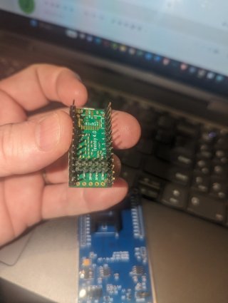

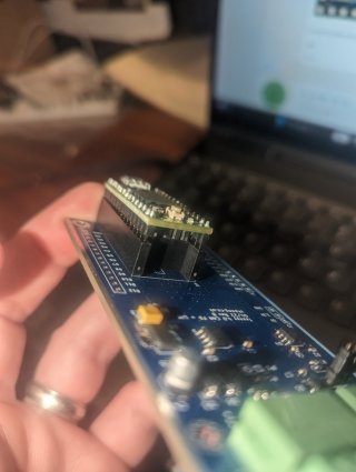

Looking at the schematics of the SK Pang board, I noticed that the CS pin of the MCP2004 LIN Transceiver is connected to Teensy pad 32. Pad 32 is on the bottom of the Teensy 4.0 PCB [left-bottom corner].
Can you actually see a physical wire or pogo-pin from that Teensy pad to the SK Pang board?
Paul
It appears so. I pulled the teensy off the board to snap these photos. I assume it was pushed together enough, but I reattached with a little more pressure to push but it will not go in all the way. Some pin is showing.

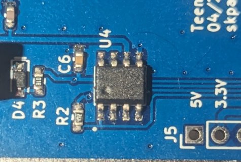

I have continuity with the multi-meter from pin 32 to breakout board at both 3.3V pins and on the MCP2004 Chip, I am getting continuity on one of the pins. Either LIN_TXD or LIN_FAULT. Cannot tell which, but here is a photo. Pin that is pinging is the one on the bottom row second from the right.
OK, thanks for the pictures - I just wanted to make sure CS is making it to the LIN transceiver. Now I understand why the Teensy 4.0 is included in the product.
That would pin FAULT.
Important is that pin 2 of the MCP2004 is HIGH when the code is active.
