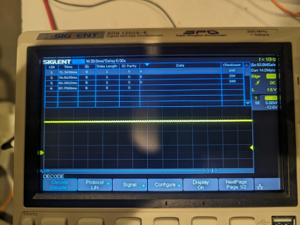

I checked with the scope on the actual LIN wire. Frames are getting out as expected:
Paul
Excellent. I will give this a go and report back to you. My oscilloscope arrives tomorrow, so hopefully I will be able to share some screenshots that look like yours.
Found out that my scope also has a LIN decoder onboard...nice!
The scope can only list 7 frames at a time, but the 8th frame is also present.
Paul
Unfortunately, I am getting -1 responses still :(
Ran at both 9600 and 19200

Just checked my code on 9600 baud and 19200 baud:
Identical as you can see.
Did you set the scope to 19200 baud?
Are you using exactly my code? I see from your IDE screenshot that void loop() starts at line 38. My code starts at line 18. So probably there is some more code in your void setup()?

Hi Paul. I was having some difficulty getting a LIN signal on that code but after a few tries, I did get a similar reading to you, but no response :(
Those bottom 2 screens are strange, ID 0x16? ID 0x18?
With respect to the scope: I used a time base of 2ms/div, and single-shot triggering on the trailing edge, trigger level around 6V.
You are not using the probes with 10x attenuation?
Paul
I am a novice with the oscilloscope. I just pushed auto adjust and tried to match your photo settings . . . not sure how to get get to 10x either. I can switch on the probe, but it stays as 1x on the scope. Also, not sure how to set those other items . . .
If your probes have a physical switch for 1X vs 10X, make sure you set it to 10X. The physical switch on the probe is the part that truly matters.
If your scope still is set for 1X, don't stress too much. The scope setting only adjusts the numbers you see on the screen. It just multiplies everything by 10. If the scope is set wrong, you'll just see numbers that are 1/10 of the correct value. So if touch 3.3V power with the probe, your scope will tell you it's 0.33 volts. But the waveform you see is correct. Only the scale is affected.
10X mode is almost always preferred, because it reduce loading your place onto your signals and it uses a combination of resistors and capacitors to couple the signal without attenuating high frequencies. 1X mode gives your scope the full voltage, but the bandwidth is terrible and your signal sees a higher load. Maybe 1X can be useful in some situation where you have very strong (low impedance) or low bandwidth signals measured in only millivolts. But for pretty much all other situations, use 10X mode.
Expensive probes usually do not have a 1X vs 10X switch. They're usually fixed at 10X. Some have an extra spring-loaded pin that gives a signal to the scope to tell it a 10X probe is connected. But cheaper probes and scopes rarely have this feature. Probes with a 1X vs 10X switch rarely (if ever) have a way to tell the scope which way you set the switch. You have to dive into a menu to configure the scope for how you set the switch. If you can't find that place, don't worry too much. Just know you need to add a zero onto the end of any voltage numbers your scope shows.
Thanks for all of that information Paul. The 0x18 is HEX for 24 and 0x16 is HEX for 22. I am leaving my scope on 1X because that is the only way I get a reading at the moment that matches your readings.
Sounds I like I need to probe all of the other ids to see if anything else brings a response, right?
I know it seems odd, but I can only get a signal on the scope with my extended code:

int led1 = 23;
int lin_fault = 28;
uint8_t linTXdata[4] = { 1, 85, 0, 8 };  // 40W, 45C, heater on
uint8_t linRXdata[8] = { 0, 0, 0, 0, 0, 0, 0, 0 };
uint8_t CRC =  0;
byte id = 0;
byte id2=0;
  pinMode(LED_BUILTIN, OUTPUT);
  pinMode(lin_fault,INPUT);
  pinMode(lin_cs, OUTPUT);
  digitalWrite(lin_cs, HIGH);  // enable MCP2004 LIN transceiver
  //lin.begin(&Serial3, 19200);  // or
  lin.begin(&Serial3, 9600);
  pinMode(led1,OUTPUT);
  if (id < 256 ) {id++;}
  //lin.order(21, linTXdata, 4);  // set power, temp and heater ON
  //delay(100);
  lin.order(id, linTXdata, 4, lin2x);
  delay(100);
  //lin.order(35, linTXdata, 4);
  //delay(100);
  //lin.order(35, linTXdata, 4, lin2x);
  //delay(100);  //wait for HVH to wakeup
  //CRC = lin.response(id, linRXdata, 8);
  //Serial.println(id);
  //Serial.println(CRC);
  //delay(100);
  //CRC = lin.response(24, linRXdata, 8);
  //Serial.print("ID 24, lin1x, CRC: ");
  //Serial.println(CRC, HEX);
  //delay(100);
  if (id2 < 256 ) {id2++;}
  CRC = lin.response(id2, linRXdata, 8, lin2x);
  //Serial.println(id2);
  //Serial.print("id2, lin2x, CRC: ");
  Serial.println(id);
  delay(100);
  //CRC = lin.response(24, linRXdata, 8, lin2x);
  //Serial.print("ID 24, lin2x, CRC: ");
  //delay(100);
  //delay(1000);
