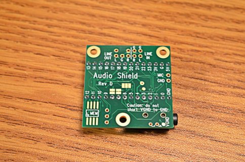

Rev D is coming soon. Here's the first prototype, on my desk right now...

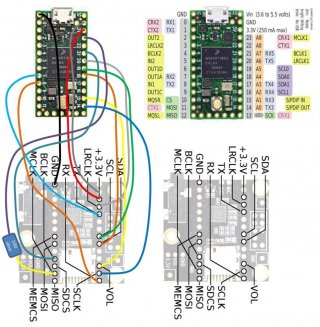

Can anyone confirm that AudioInputI2S works with the Teensy 4.0?
It does not work for me. I can play sounds out via AudioOutputI2S but I can't bring audio in using AudioInputI2S.
My Setup:
I wired up the Teensy Audio Adapter to a Teensy 4.0 using the pin remapping described by Paul (https://www.pjrc.com/store/teensy3_audio.html). Below is a picture of my wiring diagram that I made for myself.
Below is a picture of it actually wired.
Software:
I'm running Arduino 1.8.9 with Teensyduino 1.4-beta7. I'm running the ToneSweep and the PassThroughStereo examples from the Teensy Audio library.
Symptoms:
ToneSweep runs fun. PassThrougStereo, however, produces no audio at the output (yes, I am injecting audio into the system). Most curiously, going back to ToneSweep, if I simply add a line instantiating an AudioInputI2S object, it breaks ToneSweep:

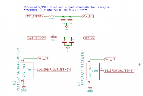

I'm working on an Audio Breakout board and it will have TOSLINK SPDIF. Let me document my findings.
- There is an Optical Audio Output Board for Teensy 3.1 at OshPark.
- There is a discussion about using WM8804 on the Teensy Forum. But we don't need this chip on the T4, because it's integrated into it.
- The new Teensy has pins for inputs and outputs of SPDIF. 14 = S/PDIF OUT and 15 = S/PDIF IN.
The part from the Oshpark board is an Everlight Electronics Co Ltd PLT133/T6A TRANSMITTER FBR OPT IR PHOTOLINK. One possible match for the receiver is a Everlight Electronics Co Ltd EAPLRAA4 RECEIVER MODULE.
It's not as easy as this, is it? I have power supply coming from the Teensy with a ferrite bead and some Capacitors, and then a direct connection from the transmitter and receiver. The ferrite bead was in another schematic I was studying, so I left it there.
I would also like to document what is required of the coaxial SPDIF output for those who prefer coaxial over optical. In the above referenced OshPark share Paul says, "Resistors and a small transformer can also be used, for non-optical RCA connector S/PDIF." I would like to also draw this schematic at some point... There are some examples online but I'll wait for feedback on the optical schematic first.
So how does my schematic appear? Will it work?
There is the small matter of (so far) no software support for Teensy 4.0's S/PDIF peripheral in the audio library.
OK, I'll still incorporate it into my breakout board. Then when there is time or interest, it will make testing easier. Does the schematic look right? Thanks Paul. I'm excited to work with this new board.
Given the different pinouts between 3.x and 4.0 for I2S, assuming the rev D board is only for Teensy 4.x, it may be helpful to those of us that serially buy boards over time, and toss them back into a bin for later reuse to add to the silk screen on the bottom saying Teensy 4.0, in addition to "Rev D". Though if the Rev D board has solder jumpers that I could easily convert it between a Teensy 3.x and Teensy 4.0 that would be even better.
