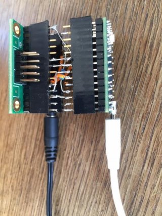

My Setup:
I wired up the Teensy Audio Adapter to a Teensy 4.0 using the pin remapping described by Paul (https://www.pjrc.com/store/teensy3_audio.html). Below is a picture of my wiring diagram that I made for myself.
Below is a picture of it actually wired.
Software:
I'm running Arduino 1.8.9 with Teensyduino 1.4-beta7. I'm running the ToneSweep and the PassThroughStereo examples from the Teensy Audio library.
Symptoms:
ToneSweep runs fun. PassThrougStereo, however, produces no audio at the output (yes, I am injecting audio into the system). Most curiously, going back to ToneSweep, if I simply add a line instantiating an AudioInputI2S object, it breaks ToneSweep:

Hiya!
I made up a quick adapter PCB to connect the 4.0 and a Rev B Audio board based on chipaudette's wiring diagram here:
https://forum.pjrc.com/threads/57167-Teensy-4-0-I2S-Support?p=212481&viewfull=1#post212481
I'm not using the passthrough so i can't vouch for it working for that, but it does make pretty sounds otherwise!

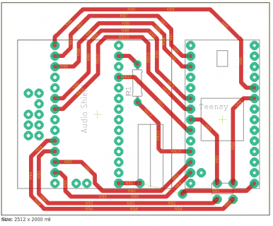

Here are the eagle files:
View attachment TeensyAudioAdapterAdapter.zip
The vias are marked in blue, and the resistor value is 100ohm
I'm just getting into milling so it's got fat traces and is single sided, but it works!

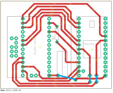

Thanks for sending me that link! I'm mostly using the synth engines, so my apologies for not digging in the posts, i missed that functionality
I'll probably hand solder in the points with magnet wire on my board but here's a double sided version of the board with the pin connections listed in MichaelMiessners post:
https://forum.pjrc.com/threads/57341-Bad-wiring-posted-somewhere-for-Teesny-4-0-to-Audio-Shield?p=214981&viewfull=1#post214981

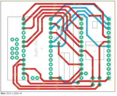

Boards and Schematic Update:
View attachment TeensyAudioAdapterAdapterUpdated.zip
Please excuse my schematic, and the board distances are set for my mill so your mileage may vary
