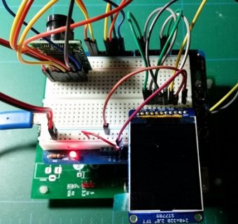

For this project I used a ST7789 2in 240x320 display along with the OV2640 ArduCAM (the T4 is mounted below the breadboard shield on a custom breakout board designed to accept Arduino type shields).

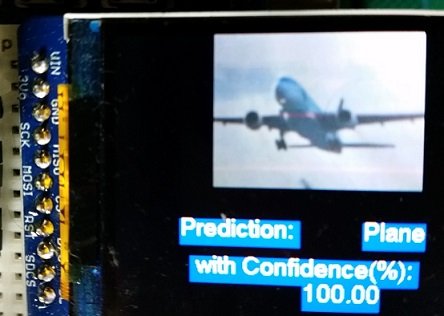

I created a Arduino style library for CMSIS-NN and incorporated it into the sketch I created to display the images. To make it work though I had to create a function to reduce the image size (320x240) bitmap down to a 32x32 image for the NN to work with CIFAR-10 dataset. The image I used for a test was of an airplane that I printed out (not very good print though as a test):
After I selected Bitmap and did a single capture using ArduCAMs interface a reduced size image along with the classification and confidence level is printed on the screen:
Note: I did test other images directly from the screen with out issue with the setup.
