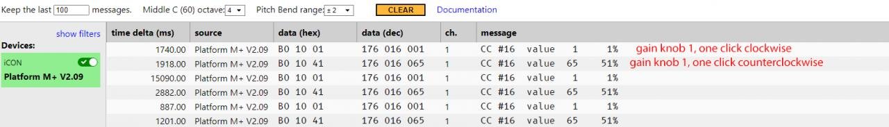

I'm trying to program a Teensy 4.0 to control my Sounddevices Scorpio.
The scorpio uses the Mackie MCU protocol to communicate with an external controller.

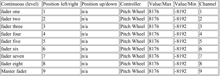

At the moment i am able to get play, pauze, stop, record working. What i want to achieve is to control the value of the faders on channels 1-12 with a potentiometer.
This is the code i have right now:
I'm very new to the use of arduino's/ teensy's and coding and i was hoping you could help me get my code working.
