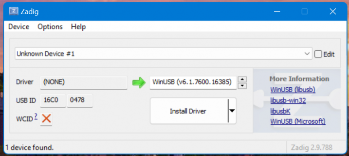

The attached photos show zadig's interaction with a teensy before and after pressing the teensy button (using zadig to view the interface not attempting to install a usb driver)

Can the Teensy Loader see it? That looks like the bootloader USB ID.

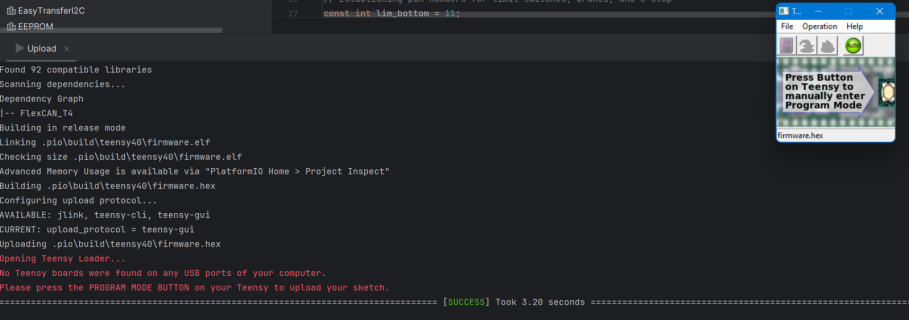

For additional reference I am using the platformio plugin for clion as my interface
Could you install the Arduino IDE, preferably version 1.18.19, and then Teensyduino.
Then see if you can program the Teensy's.
A lot of people seem to have problems with PlatformIO.
Personally I use Visual Micro with Microsoft Visual Studio. So much better than the Arduino IDE and without the problems that PlatformIO brings.

I have not installed any other USB driver, I just used zadig as it is the easiest method I am aware of to view information regarding USB ports.

p#1 suggests it was connected at one point where 'zadig' showed the port.
Then zadig accurately shows the device ID when in Bootloader mode.
