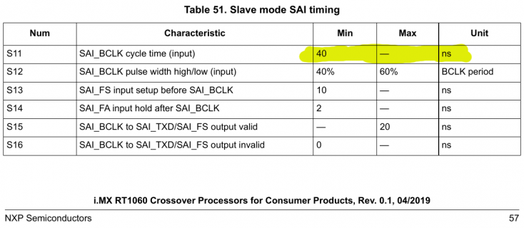

is it possible with the Teensy 4.0 to receive I2S-Data up to the speed of 50MHz BCLK ?
(2 channels * 32 bit frame-length * 768kHz sample rate)
Teensy 4.0 has to be I2S-slave / only analysing the data in the frames / no need to process the audio or to put out the (processed) audio again in this case ...
