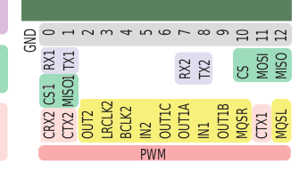

on the pin out card for the Teensy 4.0 i can find the MOSI1 and the SCK1 pins on 26 and 27 for the SPI1 channel. Are there also a MISO1 and a CS1 pin for that channel...or do i have missed/messed up someting… ?
Thank you
Torsten
MISO1 and CS1 were omitted from the current pinout card. I imagine whenever Paul prints up a new one, they will add the information. I and others have reported this in the T4 beta thread. The front card should have had:
  • Pin 0 -- CS1
  • Pin 1 -- MISO1
Card is on this Teensy 4 page :: https://www.pjrc.com/store/teensy40.html - though many common linking pages and side bars don't have that link.
But Paul and Robin are plenty busy making more Teensy T4's, etc … having shipped all they got. Plus all the other things … Schematic, OSH breakout, released Teensy Duino 1.47
The card issue was discussed on the Beta thread as noted - some weeks back when the first batch of cards were printed in advance to get them ready and not hold up shipping - it was stated that when the first batch of cards is gone they will be updated.
It might look something like this mock up posted 6/13/19:

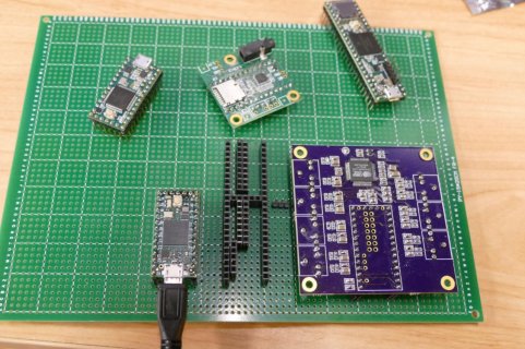

I built a Teensy audio playground breadboard that uses a T3.2, a T3.6, or a T4.0 and either a PJRC Audio Adaptor or Paul's CS42448 board. I used the 1.46 beta 5 code with the fix to the output I2S file. All 6 combinations of the board worked using the Guitar code to test the output functions. Inputs were not tested as they are not needed at this time. The breadboard will be used as an 8 output sound source in a music synthesizer project. P2920706_x.jpgP2920711_x.jpgP2920708_x.jpg
