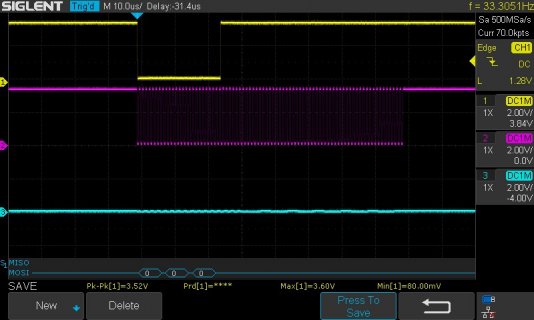

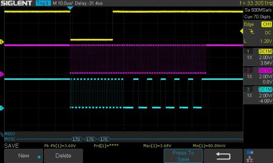

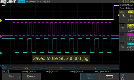

(Note this is with exactly the same code as I posted previously, but added "pinMode(DAC_CS, OUTPUT);" to setup() and "delay(3000);" changed to "delay(30);" in loop(). )
However, while this fixes the infinite loop issue, the SPI lines are still not behaving appropriately. Here's CS, CLK, and MOSI (yellow, purple, blue) without my board attached, then with. Note that these aren't on the same timescale. Long story short, there is mysteriously extra data and the clock goes on too long (and idles high, not low). Note this same behavior occurs with only GND and pins 10 (DAC_CS) 11 (MOSI) and 13 (SCLK) connected.
What could my board be doing to mess up the Teensy's SPI output? These lines aren't driven when the teensy is not connected. Could it have to do with load on the clock or MOSI?

Sure @KurtE can explain the details for the clock and the transfers. I usually look at the CS if it low the transfer occurs and the data that is transmitted and recd. @KurtE convinced me to get a Logic Analyzer for things like this and its a lot easier to see whats going on.
Perhaps your PCB is causing very fast reflections on the SCK line that are causing glitches inside the T4 SPI controller. I think SPI.begin sets up the port pins for SCK and MISO and MOSI for the strongest drive (IOMUX_PAD_DSE(7)). You might try choosing one of the weaker drive strengths that are commented out in SPI.begin().
If you are connecting SCK to all 34 ADG1414s, that's a lot of capacitive loading on SCK (9pF x 34). If I had designed that board, I would have put a buffer between the SCK input and all those analog multiplexers.
Weirder still, if instead of placing my Teensy into the socket on my PCB, I connect the Teensy to the socket via 6" long jumpers, I do not have this issue with SPI.transfer failing, and my oscilloscope shows correct SPI operation.
In this case, the jumper wires may be changing the timing of echos from the PCB.
I just ran a quick LTSpice model of a 1MHz clock driving 300pF through a 20-ohm resistor (20 ohms is the nominal output impedance of the SCK pad at maximum drive strength). The model showed a current spike of about 150mA at the clock edges. The combination of low output impedance and high capacitive loading is certainly putting a strain on the pad driver and any circuitry on the same power supply traces inside the MCU.
I added an inductance of 6uH in series with the resistor---about what I measured for the inductance of a 6" stranded jumper wirre--and the peak currents went down to about 16mA. That might explain why things worked when you connected with jumper wires.
I think my earlier characterization of the problem as 'reflections' was poor choice of terms.
I think it's also important that the capacitive loading causes both positive and negative current spikes through the SCK pin. Depending on the on resistance of the MOSFETS driving the pin, those current spikes could be doing bad things inside the chip.

I tested my hypothesis about the pad drive of a highly capacitive load by connecting two 150pF capacitors from SCK to ground.
I then ran the OP's original simplified test program. Here are the results:
with "uint32_t fastio = IOMUXC_PAD_DSE(7) | IOMUXC_PAD_SPEED(2);"--the default setup in SPI.begin. 300pf on SCK Program hangs after first 'Transferring'
with "uint32_t fastio = IOMUXC_PAD_DSE(7) | IOMUXC_PAD_SPEED(2);"--the default setup in SPI.begin. 150pf on SCK Program hangs after first 'Transferring'
with "uint32_t fastio = IOMUXC_PAD_DSE(2) | IOMUXC_PAD_SPEED(1);"--lower drive and speed in SPI.begin. 300pf on SCK Program runs properly and continuously
This seems to confirm my hypothesis that setting up the SPI pad drive properly will correct the issue of failing SPI transfers when SCK is connected to a large capacitive load.
Thanks so much everyone for all your help!
mjs513 - Sorry, that was definitely info that should have all been in the first post! I'll definitely work on explaining my problems better!
mborgerson - thanks so much! this definitely fixes my test program, and provides some insight to me as to how I might run into problems here. I'm still running into some issues in my actual program (haven't yet made a minimal program that reproduces the next outstanding bug), but I think this strongly suggests I need to fix the clock line by adding some kind of buffer. You mentioned that "If I had designed that board, I would have put a buffer between the SCK input and all those analog multiplexers." - do you have a go-to chip you'd recommend off the top of your head?
I don't fully understand a lot of the NXP pdf you referenced (though I have a feeling I'll be going over it a lot in the next couple days) - are the parameters you suggested the most extreme in terms of limiting drive strength and speed? I see there's also a slew rate parameter, but I'm not clear how to set that.
I have made circuits with SPI before, but never with anywhere near this many components (typically 1-4).
KurtE - I have daisy-chained the ADG1414s data lines (the Teensy's MOSI only drives the first one) with pullup resistors on each SDO->SDI connection, but they all receive the same clock line, and there is a "CS"-like input called "~SYNC" that I drive from the Teensy that pulls every ADG1414's ~SYNC pin low synchronously, during which I clock out 8*34 = 272 bits, then set ~SYNC high to set the switches.
All devices are powered off a DC/DC converter module (TMR3-0521) that is running off the USB input power. I'm also using the Teensy's 3.3V regulated line for providing logic-level references for a few chips, but it shouldnt be providing any significant amount of current (definitely order of magnitude below the 250mA limit). In my testing so far, changing the power connections has made 0 difference in terms of my SPI problems. For example, it doesnt matter if I connect or disconnect that 3.3V pin, or if I enable or disable the DC/DC converter.
You advice on trying smaller subsets is a good one and mirrors mjs513's earlier advice; I'm just not 100% sure how to do it with these DFN chips, since I can't just breadboard them, and even soldering them isnt something I'm really sure how to do properly - my soldering limit is basically a hand soldering iron with 0402s and TSSOPs).
