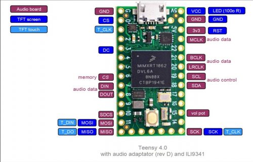

Teensy 4.0 with Audio Board and ILI9341 screen wiring

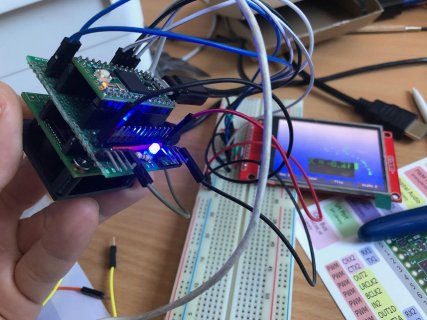

thanks for your reply.
Good news therefore for the Reset pin, a saved pin!
First learning tests (as a reminder I am a beginner):
TFT_CS = pin 0
TFT_DC = pin 3
TOUCH_CS = pin 1
with the audio card connected, I display on the TFT the peaks of the microphone, and I use the touch screen => it works very well
First experience with my TFT is conclusive.
Now I have to test the SD card and the onboard memory on the audio card
My montage looks like a dish of spaguetti, so does a breakboard for T4 + audio board + tft exist ?
Note in your picture you need a few extra pins:
  • If you use flash memory or the micro SD card reader, you need to connect the ground pin on the left;
  • You always need to connect the ground pin on the right (second pin from top); (and)
  • You always need to connect the 3.3v pin on the right (third pin from the top).
I'm not sure whether you need to connect VIN on the right (top pin). I don't think you do, but I don't know if the amplifier needs more power than 3.3v can supply.
The reason for the two grounds being used for different things is the Teensy 3.1/3.2/3.5/3.6 uses the ground pin on the left for normal ground, and the ground pin on the left is an analog ground pin, meant for grounding analog inputs/outputs. Hence on the revision A-C audio shields, the ground on the left is used for the SPI devices, and the ground on the right is used for the analog stuff. Presumably when Paul redesigned the revision D audio shield, he did not cross connect the two grounds (Teensy 4.0/4.1 don't have analog ground).

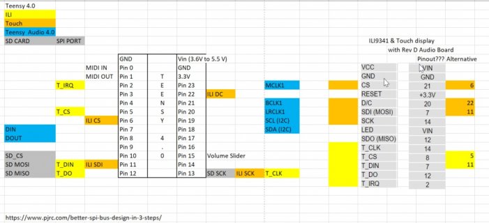

Teensy 4.0 w SD Card w Audio w TFT ILI9341 w Touch (XPS)
I think I may have found the right thread...
So, I am trying to get all the following to work: Teensy 4.0, with the Audio Adapter rev D - I need to use its SD Card. Also, I need to connect it to a touch screen based on the ILI9341 and Touch XPS chipset.
Based on what I have read this far, I came up with the attached - would this work?
I can do soldering tomorrow and finish the code for setting this up - if all works I volunteer to a small write-up that we can help Steve with, I think others may benefit from a small update to the current page (https://www.pjrc.com/store/display_ili9341_touch.html).
Thank you in advance for your guidance.
A couple of minor comments:
1) Pin 6 is used by the audio shield if you solder a flash memory chip to the audio shield (which can be a faster but smaller permanent storage device than the SD card). Even if you don't solder in a flash memory chip, it might avoid problems if you use a different chip for the CS pin select.
2) On SPI systems that have multiple devices on a single SPI bus, it can be helpful if you have pull-up resistors on each CS pin. Note, the audio shield adds pull-up resistors for both pins 6 (flash memory) and 10 (micro SD card reader), but you may need one for your display.
3) As the paper above mentioned, some devices no do properly handle tri-stating. On the Teensy 4.0 you could move the display to the second SPI port, but you will need to solder 2 wires to the pads underneath the Teensy. Note, pin 1 is MISO1 (it isn't on the pinout card unfortunately), which means you would have to re-route the MIDI connection from Serial1 (i.e. pins 0/1). I think you can buy tri-state buffers also, but I don't have any experience with this.
4) You aren't hooking up the reset pin on the display. You might want to hook it up to a pin, and explicitly reset the device when needed.
5) I've read about different ways touch sensing are communicated. If it uses I2C, it should be ok, providing you don't use the two I2C ports used by the audio shield. If it is a SPI connection, I recall some of the devices in the past had trouble with tri-stating. I've never used touch screens in my usage.
6) Generally, I try to do hookups, etc. on a breadboard first before moving to a soldered connection. That way you can verify that it works first, and possibly move pins around as needed before going to solder. If you go straight to solder, it could be you need to change pins, or it could be your solder connections need to be fixed, so it can be harder to figure out what the problem is. Of course the downside is, I've had ports on breadboards stop working, and using cheap jumper wires can sometimes stop working also.
7) Particularly on a fast Teensy like the 4.0, you can overwhelm the display by sending data too fast. It may be helpful play with the SPI bus speed if you display is glitching. I've found that even for the same driver, different manufacturers displays might top out at different SPI bus speeds.
