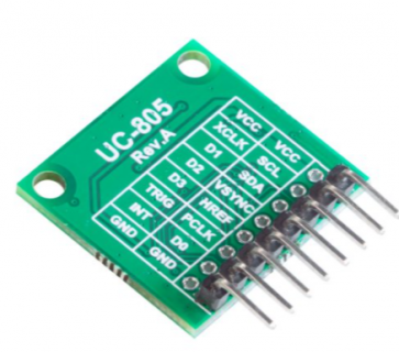

First, the library does not support the 1-bit mode for data transfers. Second the link you provided will require some additional connections that don't seem to be there:
So you will probably have to solder on some additional wires or another header or....
As for the connections. We never tested with a T4 but it should work with the right combination of pins. The library uses FlexIO for controlling the IO so have to map Teensy pins to FlexIO pins (https://github.com/KurtE/FlexIO_t4) with that said this seems to run without giving pin configuration errors:

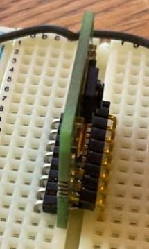

Thanks @mjs513! I soldered a pin header and connected as you suggested except SDA/SCL which is 18/19 on T4. There is no corresponding EN pin on the Arducam (hm01b0) so I did not use it. Since I am not using display and SD card, I have modified the HM01B0_ML_example.ino to keep it minimal for testing, just sending image to SerialUSB1. The Serial monitor shows logs below:

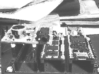

I opened the CameraVisualizerRawBytes.pde and it displays some unrecognizable garbled pattern. I played with the settings and the framerate=15 had a bit success and I was able to see grayscale image momentarily with rgb mess (see URL below) but it is not rendering correctly.
https://imgur.com/a/GMg5ywQ

I have modified the Processing script to capture based on header. It seems image is OK now but it works only with frame rate = 15 and has a lot of flickering. I used same camera with RP2040 and it works fine. Maybe I will try to hookup a display to see if it is USB serial timing issue.

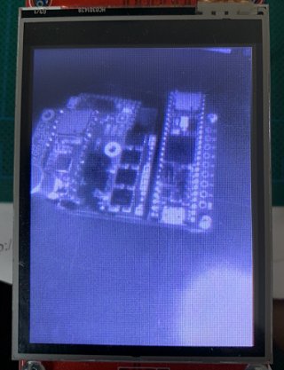

I was able to connect a display (ILI9431) using SPI (MOSI1/SCK1) pads on the back of T4. It has same issues. It works only with frame rate=15 with heavy tearing or flickering. Please see the gif below ('V' or 'F' both have similar output).
https://imgur.com/a/9jTBCZI
What settings should I play with to fix this?
I was able to connect a display (ILI9431) using SPI (MOSI1/SCK1) pads on the back of T4. It has same issues. It works only with frame rate=15 with heavy tearing or flickering. Please see the gif below.

Are you using your sketch or the ML-example sketch using the video options = 'F' or 'V'. Also there are some hints in the readme.
Would suggest that you try changing using the sparkfun configuration by adding this at the begining of your sketch:
#define USE_SPARKFUN 1
see if that helps. Their might be another option but I want to test it first.

In your previous sketch you are sending 1 image at a time in BMP format to USB. So I am assuming you are using something like this to send images to the display:
        Serial.println("Reading frame");
        memset((uint8_t*)frameBuffer, 0, sizeof(frameBuffer));
        hm01b0.readFrame(frameBuffer);
        Serial.println("Finished reading frame"); Serial.flush();
        tft.setOrigin(-2, -2);
[B]        tft.writeRect8BPP(0, 0, FRAME_WIDTH, FRAME_HEIGHT, frameBuffer, mono_palette);
[/B]        tft.setOrigin(0, 0);
which is the 'f' option in the ML-example.
But as I said you should try using the video options in the example to send to the display. You haven't really made it clear what sketch you are using or what options you are using. At this point not sure other options - can you post your whole sketch and I will try it later today and let you know.
One other possibility is to add use 30frames per second and add a small delay between frame outputs - just guessing here.

@mjs513 Something interesting I discovered accidentally! If MCLK is not connected to the Arducam (XCLK pin), it works well with all frame rates.There are tearing when moving fast in 'V' mode and somewhat negligible tearing in 'F' mode with fast movement but slow movement images are quite smooth. If we fix the MCLK clock, I think rest of the tearing will be gone.
Thanks for the find - one thing that I didn't check before this was a comparision of the pins between the TMM camera and the Arducam. Again great find. Ps - in between home related projects so will definitely play later.
@yokonav
I did get a chance yesterday to test the Arducam out, but I was using a T4.1 - only because it was easier to hook wires up to it on a breadboard. ILI9341 on SPI1 and the camera using the same pinouts. Was not happy with the results.
Camera on Micromod: Image_20210729_134140.png and Arducam on the T4.1: 9px_0002.png
Hard to see from the pictures but the image from the Micromod is actually better and less fuzzy. Did try a couple of things:
1. Used the Arducam Initialization Registers and no change. Comparing them to the default initialization they look to be exactly the same.
2. Tried a few different settings with no luck - just made it worse or no change.
Wondering now if the Arducam actually supports 4-bit mode based on other images I looked at. Going to play some more today and will amend post as necessary.
Morning, @mjs513 - I will try to play today as well. Been busy with some other things. You would think that they would both work the same, but could be wrong.
might help to see your settings. (i.e. which pins), to see if I notice anything
As I mentioned on a different channel, I did solder up my camera with 2nd row to make it easy to connect on Breadboard:
What I need to remember is how we mapped from FlexIO pins to image. That is if we did some masking and shifting, or if we needed the 4 bits to be in contiguous FlexIO pin order and we pass off the starting pin number to the FlexIO system..
