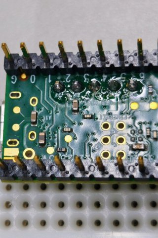

I'm currently working with a Teensy 4.1 and I'm running into an issue where USB communication doesn't seem to work properly — the board is not detecting my USB mouse at all.
I soldered pin headers to the USB Host (5-pin) pads on the Teensy 4.1. However, I’m concerned that the D- and D+ data lines might not be connected or functioning correctly.
To verify this, I tried checking continuity between the MicroUSB connector’s D-/D+ lines and the USB Host port’s D-/D+ pads. Should there normally be continuity (a beep) between these points? On my Teensy, I don’t get any continuity.
The 5V line on the USB Host port is present and confirmed, so power seems fine.
Is there any proper or recommended way to verify whether the D- and D+ lines of the USB Host interface are working? Or is there a method to diagnose whether the USB Host circuitry on the Teensy 4.1 is functioning?
Any suggestions or troubleshooting advice would be greatly appreciated.

No, because they are completely separate ports.

In that case, what is the correct way to check whether the D- and D+ lines on the USB Host port are working properly?

Typically when the port is idle, both D- and D+ should have approximately 15K resistance to GND. The readings you actually get can vary quite a bit depending on your meter.
Yes, there a couple ways to test. The hardware gives you a way to read whether the pins are in J, K or SE0 state. When Teensy 4.1 is tested, the bed-of-nails test fixture drives D+ and D- pins and uses that capability to confirm the pins receive correctly. I can assure you every Teensy 4.1 does get these data pins tested before it ships!
The hardware also has a special test mode which can drive the pins. Before today I never tried to use it. Turns out it's pretty simple. Here's a program which is similar to LED blink, but for the D+ and D- signals.
CAUTION: disconnect all USB hubs and devices before running this program!
Logic high should measure about 0.78 volts with a normal 10M impedance multimeter. This is high speed USB, so don't expect ordinary 3.3V signals. Please understand the USB 2.0 spec is about current delivered to a load impedance, so 0.78V isn't a rigid spec... it's just the number I saw when I ran this here on a Teensy 4.1.
Logic low should be close to zero. My multimeter reads 0.02 volts when both are low, and 0.006 volts when the other pin is high (0.78V).

I measured the D- and D+ lines using the code you provided. Here are the results:
Measurements between D- and GND:
  • D+ high, D- low: ~780 mV, 20.4 mV
  • D- high, D+ low: ~780 mV, 0.78 V
  • D+ low, D- low: 5.6 mV
Measurements between D+ and GND:
  • D+ high, D- low: ~780 mV, 0.795 V
  • D- high, D+ low: ~780 mV, 20.9 mV
Based on these readings, is it correct to assume that the D- and D+ lines are working and recognized?
I’m relieved to see the voltages are present.
Thank you very much for your help—I really appreciate it!
Yes, seems very likely your hardware is working. Those measurements closely match the voltages I see here with a working Teensy 4.1.

Your program from msg #6 is missing USBHIDParser.
First I ran the example program by clicking in Arduino File > Examples > USBHost_t36 > Mouse with a Logitech B100 mouse connected to Teensy 4.1. The example Mouse program works fine.
Then I ran your program. It does not work. Then I coped 1 line with USBHIDParser from the Mouse example. Your program appears to work with this 1 line added. Here is the result I see in the Arduino Serial Monitor when I move the Logitech mouse after uploading the program.

I did not connect anything to pin 33. This test was just the Logitech B100 connected to a Teensy 4.1 by the USB Host Cable.
