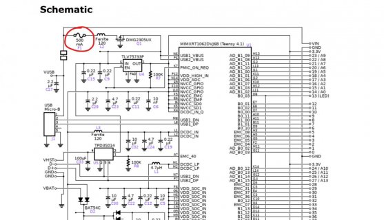

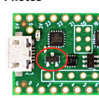

Anyone know what the footprint of this little F1 fuse is? Trying to find replacement part

The part you circled in the schematic is F1. It's 0603 size.
The part you circled in the photo is Q1. It's SOT-23 size.
If F1 broke off the circuit board, you can get the board running by just soldering a wire in its place.
The F1 PTC fuse I suspect, is this part: https://www.digikey.com/short/5t5fjzj3

But as Paul already said two years ago, you have Q1 circled in your picture.
