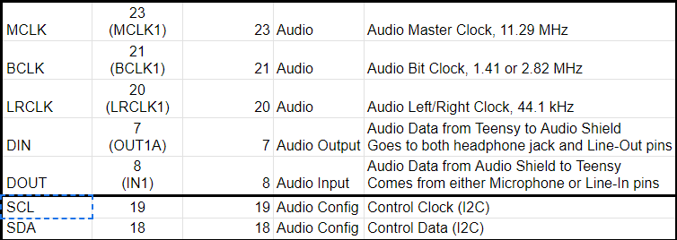

After looking into Teensy and Audio Shield D2 pins, I made a spreadsheet and it's simple, it's basically one to one match (eg: MCLK is pin 23 on both boards, SCL is pin 19, etc).
I also believe I probably only need the following pins as the goal is just to play audio to 3.5 mm jack and record from a microphone, and the SD card will be on Teensy:
Can you please confirm ?

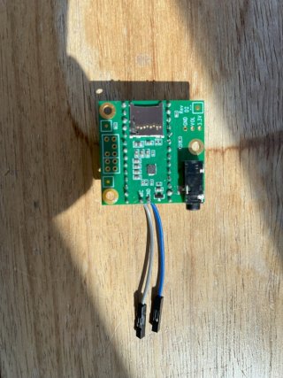

For now, I soldered pins into the Audio Shield D2 and two wires so later I can plug the microphone like this:
I tried to stack both boards one on top of the other with the matching pins and I can't hear sound via 3.5mm audio jack.
