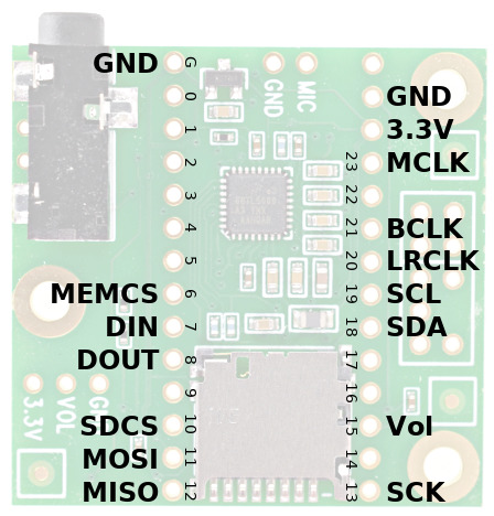

The Audio shield does not use 5V and there is no connection to that pin - silkscreen supplied perhaps just for orientation.
This image showing the active pins from the product page explains why there are no traces leading from the 5V pin on the PCB
My apologies for not being more clear. I have the Teensy and Audio shield connected using stack-able headers. I am powering the Teensy4.1 through the 5V pin, which I assumed would drive the 3.3V output to power the Audio Shield. Is this incorrect?
I did notice in further testing that if I wire the Audio Shield's line in directly to the mic+9814 output (output to L and ground to ground) and not connect it to the shared ground as I have in my diagram, I get some audio out, although the output is drastically reduced. I am doing my best to try and investigate this, but I am also fearful of damaging something. If there are any references or resources I could look at, I would be very grateful.
