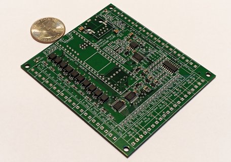

I have finished my grblHAL CNC Motion Controller board for Teensy 4.1.
Completed board
Unkit Version
Features:
  • 5 Axis control outputs – 5V compatible.
  • Independent enables for each axis.
  • 10 Opto-isolated inputs including standard GRBL controls and limit switches for all axes.
  • 7 Relay Outputs – Spindle, Mist Coolant, Flood Coolant, Dust Collector and 3 auxiliary relays. Each output can control a relay coil directly or 5V TTL (SSR compatible) devices.
  • Dust Collector relay support. Activated by spindle enable.
  • Separate control of Dust Collector relay via pin header.
  • Relay coil voltage switchable between 5V and 12V.
  • Standard GRBL spindle control outputs – 5V compliant.
  • 0-10V spindle control output for driving VFDs.
  • Screw Terminals for reliable connections available for most I/O.
  • 4 Digital Inputs – EMI protected, 15.9KHz low pass filter, Schmitt Trigger.
  • I2C header.
  • EEPROM footprint for SOIC8 devices.
  • LED indicators for 5V and 12V.
  • USB interface.
  • Ethernet interface.
  • Serial I/O Header
This runs grblHAL, a 32 bit ARM port of GRBL. The source code is here.
Schematics can be found here.
I've uploaded a shared board to OSHPark here.
Though, to be honest, it would be cheaper to take the gerbers and order the board from a Chinese fab like JLCPCB. Gerbers can be found here.
I have a small number of boards with all the surface mount components (except the eeprom) already soldered on - AKA the Unkit Version. If interested, you can get one here.
I have a manual near completion and will post it on the github page here when done. It includes a BOM and assembly instructions.
In addition, the PCB has the footprint for an Ethernet MagJack. The hardware works but Ethernet for grblHAL on the T4.1 is not completed. I am hoping to get that working within a week or so. Check the github page for status.

There was a question about max step rate supported. After some testing, I have been able to produce a 180kHz step pulse stream. Minimum pulse width is 3 uS. You can get to 300 kHz but that probably violates min pulse separation for your stepper drivers - it looks like a spec of 2.5 uS is fairly common, even on higher end drivers. So, 2.5 uS separation and 3 uS pulse width gets you 181.818 kHz. Note that acceleration/deceleration will make that step rate relatively infrequent when running a job. Here's a screen shot of a 148.8 kHz stream.

After looking at this a lot more, I've decided to put the max step rate specification at 160 kHz. Quite a bit better than the old 8 bit GRBL of 30 kHz. It can go higher but I don't feel confident of 100% repeatability above 160K. That will support 5000mm/min movement and higher. Of course that depends on stepper drivers, motors, gearing and microstepping being set correctly.
