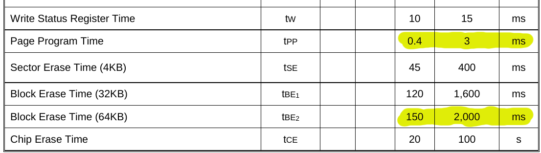

I am wondering, if the FS still lives after you reprogram the Teensy? For example by default does the Teensy loader clear all of the Flash or only the pages it needs to write the new image?
Assuming that the whole flash is not erased, Is the FS setup such that if the image size changes such that the starting address changes, will it survive.
Or another way of asking does SPIFFS start using the flash starting at the start address or does it or can it start its allocations at the end just below the EEPROM area and work it's way down.
Or optionally can we tell it to start at some specific start location like the 4mb mark?
