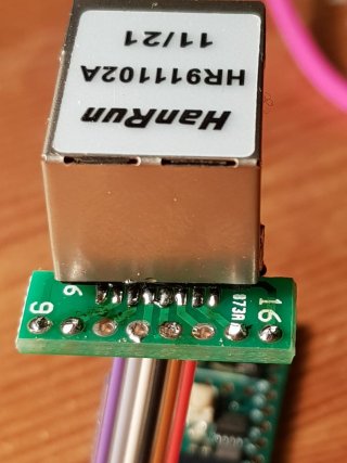

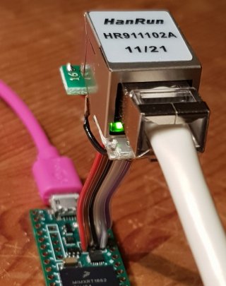

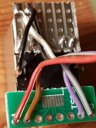

HanRun HR911102A can probably work. [...] The PHY chip on Teensy 4.1 does all the impedance stuff internally [...]. Connect RDC and TDC together and use a 0.1 uF capacitor between RDC+TDC and GND on Teensy. Then just connect the 4 signals directly, no extra resistors or capacitors. Also connect the S1 & S2 ground pins directly to Teensy's GND. The LED output on Teensy 4.1 is active high, and it has the resistor built in. So if you want the LED to show link status, connect the LED output to pin 9 on HR911102A, and connect pin 10 to GND.
