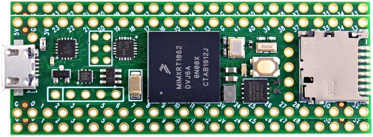

Plans for T4.1 Ethernet library
I was wondering what are the plans for the software support of the native T4.1 Ethernet. Will the https://github.com/PaulStoffregen/teensy41_ethernet be extended upon towards Arduino Ethernet library compatibility, will the Arduino Ethernet library be enriched with native T4.1 Ethernet support, or will the focus be on lwip supporting the T4.1?
Kind regards,
Sebastian
My beta board has yesterday reached Italy. still waiting.
Meanwhile, I ordered some T4.1 from Exp-Tech.de, arrived via USP in no time. (No custom issue within Europe)
Is that the sketch from : Teensy-4-1-Beta-Test that post Paul posted 5/13?
>> github.com/PaulStoffregen/teensy41_psram_memtest/blob/master/teensy41_psram_memtest.ino
If so it would start like:
Code:EXTMEM Memory Test, 16 Mbyte CCM_CBCMR=B5AE8304 (88.0 MHz) testing with fixed pattern 5A698421 testing with pseudo-random sequence, seed=2976674124 testing with pseudo-random sequence, seed=1438200953
or:
Code:EXTMEM Memory Test, 8 Mbyte CCM_CBCMR=B5AE8304 (88.0 MHz) testing with fixed pattern 5A698421 testing with pseudo-random sequence, seed=2976674124
or:
Code:[COLOR="#FF0000"]EXTMEM Memory Test, 0 Mbyte[/COLOR]
Depending on the size of PSRAM recognized.
It will give good feedback if soldered and working right.
FLASH or 2nd RAM

@wwatson, did you solder it in to where the smaller pattern is on the back of the board? (around pads 31-32?)
You might, retouch each solder joint with solder iron to make sure good contacts, and check for any shorts...
Also at times like this, I use the hilow test sketch that @defragster and I hacked on awhile ago to see if all of the IO pins appear to work.
I think one of t last places that sketch was posted was up at: https://forum.pjrc.com/threads/3875...-(ILI9341_t3n)?p=226808&viewfull=1#post226808
And several places have documented what each of the pins on these patterns are. Including my excel document:
Pardon the spacing of quick copy/pasteCode:FLASH or 2nd RAM 4.26 1:12 RX1 P 52 GND 4.25 TX1 P 53 50 P CTS8 MOSI2 1:14 4.28 EMC_28 4.29 1:15 MISO2 P 54 49 P SCK2 1:13 4.27 EMC_27 3.3V (pin 1) 51 P SCL1 4.22 EMC_22 RAM 4.26 1:12 RX1 P 52 GND 4.25 TX1 P 53 50 P CTS8 MOSI2 1:14 4.28 EMC_28 4.29 1:15 MISO2 P 54 49 P SCK2 1:13 4.27 EMC_27 3.3V (pin 1) 48 P RX8 4.24 EMC_24

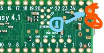

The PCB is completely filled with routing on all 4 non-plane layers, and even a few signals escape along the edges of the ground plane layer. It just wasn't possible to escape any more signals to the right hand side of the PCB.
Yes there are 30 GPIO pins that i can count, that is not routed from the MCU.
As you probably already know, the T4.1 has already shipped, so very unlikely anything will change.Yes there are 30 GPIO pins that i can count, that is not routed from the MCU.
You could widen the PCB and stack the pins, this way it's also compatible with the old layout.
Some extra GND pins could be very nice, specially if you think about high speed signals that need short GND distance.
Yeah - just got my coffee and decided to look on the back of the T4.0 card and sure enough. Thats what I get for using your spreadsheet all the timeThe one I cut is between the two big pads in your redish/orangish colors...
Technically you only need to do it if you plan to plug in a USB cable and provide external power at the same time. If you only provide one power source, then you don't need to cut the solder pads.OK this is going to sound like a silly question at this point in time but my memory is failing me, where is the trace I have to cut to separate Vin from USB if i want to use external power?
@All - just to let you know I touched up the soldering job on the extram chips on the one T4.1 board that I was having a problem with. That fixed the the issue I was having with having to add delay's to the config portion of startup.c.
You guy's were right about the soldering job I did. The T4.1 is showing 16MB's of extram using @paul's test sketch without the delays.
What I don't understand is why the actual memtest portion still worked without the delay when the solder connections were feeble
Thanks for the push.
