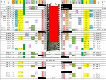

But I think you SPI markings for 38-41 got shifted a couple pins should be on 36-39?
Hmmm, you have the flash/psram pads underneath the Teensy 4.1 as being alternates for SPI2 (i.e. MISO2, MOSI2, SCLK2) which is the SPI bus used for the micro-SD card. Does this mean that if you were to want to have a sketch that reads from both the SD card and the attached QSPI memory that you would have to keep switching the pins between the two?Hi @Paul,
I am going through and doing a quick review of your card versus my card/tables...
Found I had issues with my PWM markings, which I correct on mine.
That is I believe 39 is alternate to MISO1 not 41
The QSPI memory accessed with FlexSPI2, which is completely different and separate from all 3 of the normal SPI ports. It's also separate from FlexSPI1 which is used for the main program memory. The FlexSPI ports are designed to map memory chips directly into the ARM's address space. They are very fast and feature another layer of caching between the processor's L1 cache and the actual QSPI memory. FlexSPI is a completely different type of peripheral than the regular SPI ports.
Nope, there's no conflict here.
The SD card is accessed using SDIO (native 4 bit data + cmd). SPI2 isn't used for the SD card. But if no SD card is present, those pins can be used as GPIO or SPI2 or Serial5... that is, if you're able to solder tiny wires to the exposed parts of those SMT pads on the SD socket.
SPI2 isn't used for the QSPI chips either (even though those pins could be used for SPI2 if memory chips aren't installed). The QSPI memory accessed with FlexSPI2, which is completely different and separate from all 3 of the normal SPI ports. It's also separate from FlexSPI1 which is used for the main program memory. The FlexSPI ports are designed to map memory chips directly into the ARM's address space. FlexSPI is much faster than regular SPI. It's triggered automatically by when the processor uses its bus to access memory to fill or flush 32-byte L1 cache lines. The FlexSPI ports also feature another layer of caching between the processor's L1 cache and the actual QSPI memory, so the bus isn't tied up while the QSPI memory transfer happens. FlexSPI is a completely different type of peripheral than the regular SPI ports.
