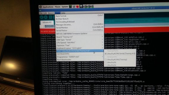

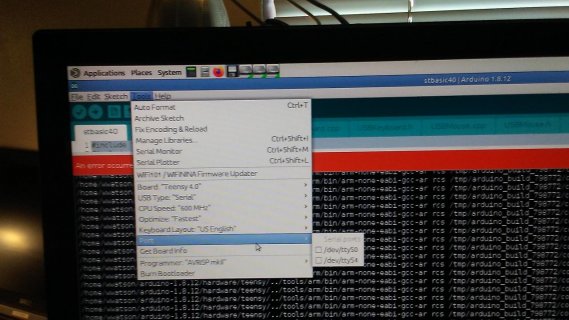

@Paul - I finally have everything ready. I made sure that I used a fresh copy of Arduino 1.8.12 for installation of both TD's.
When using TD 1.52B1 stbasic40 uploads without a problem. The Teensy port /dev/ttyACM0 shows up and Arduino sees it:
And no program button press is needed each time stbasic40 is compiled and uploaded.

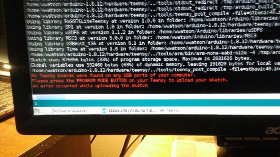

Using TD 1.52B3 will compile and upload but the RA8876 screen will remain inop. The backlite will not turn on. I have a belkin USB HUB with a power on LED and it will not lite up. Normally after the RA8876 is initialized the LED on pin 13 will go out but it remains on. When I check the port status int the tools menu of Ardino /dev/ttyACM0 is not there:
Then when I try to recompile and upload again I get this error:
I have to press the program button to get stbasic40 to upload but make no difference. The Teensy remains inop.
It seems to me that something is going wrong before or during reboot.
If I upload another sketch say blink.ino I have to press the program button again to get it to upload. After that I can compile and upload other sketches other than stbasic40 automatically.

Actually to be honest it sounds very familiar but not don't think its a display issue. Always to seem to have the problem with the T4 even during beta testing. Typically it would appear to hang and I would have to hit the PGM button to upload again. If you I loaded BLINK after the faulting program (HINT) I could upload pretty any other sketch like BLINK again and again without hitting the button.
Think whats happening is that there is a memory access issue somewhere in the program I was using - was trying to load a sketch that went over a memory boundary (guess that's the right term), program would fault and I would have to hit the program button again. Had that problem with my OpenGL stuff until I started moving some stuff out of RAM1 using malloc or FLASHMEM for functions. Once I cleared some space it would work again. May need to add your debug_tt to get the error messages out.

@Paul - Don't bother wasting time on my problem. I figured it out. I was using flexRAMInfo to monitor memory usage. It works with TD 1.52B1 but not TD 1.52B2 or TD 1.52B3. I eliminated those calls and both the T4.0 and T4.1 came back to life with stbasic40. Sorry to waste your time with this.
I am sure there is a fix for it and will be found:)

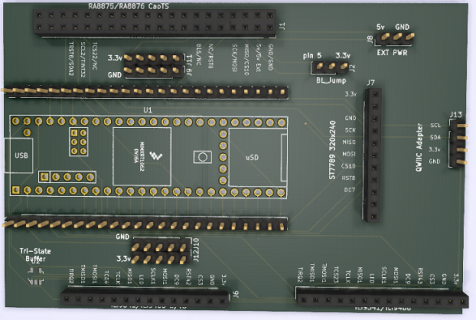

Ok just finished a new T4.1 breakout board to test a few of the different displays. Getting ready to order them and then debug. Here is a screen shot. Unfortunately the RA8875/76 is setup for capacitive touch - sorry @wwatson.
Yes added pins for a Sparkfun QWIIC adapter board. Not sure if I need anything else just for Testing displays.
