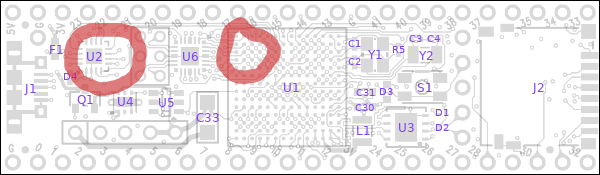

My best guess is somehow you've lost connectivity between the U1 and U2 chips. These are the areas where their connections are located.
First visually check for any damage. If nothing is obviously visible, try pressing on that corner of U1. Sometimes thermal or physical stress to the BGA chip can cause some of its pins to come disconnected, where pressing can cause them to touch.
I never exposed my teensy to physical or thermal stress. There is no visible damage to the board and pressing the marked corner changes nothing.

2 blinks on the red LED comes from the bootloader chip (U2) which means it can't communicate with U1.
The main processor (U1) may or may not still be running a program if U2 isn't connected to it. In other words, U1 might still be working fine and the lack of communication between the chips might be physical connectivity related. But it's also possible U1 got damaged in some strange way. Very difficult to know what really happened.

So, the use of the word 'reset' was used out of habit. I know its a 'Program' button but thanks for double checking my knowledge on the matter (or rather correcting my terminology). So, Its certainly bricked. I have put this down to a faulty connection (probably caused by a microscopic :-( solder ball that I failed to capture on the microscope before powering up). I can confirm I have successfully repopulated another PCB (luckily I have 5 and only need 2), hot aired the teensy 4.1 onto it and now all is working. Lessons learnt: Check, clean, check clean check clean, check again...wait a day, check again, then power up!

I know it has been awhile since this form was last active but I had the same issue, 2 blinks and a 1-2 second pause.
What I did was use a fair amount of force to push down on the main chip, make sure to have device manager open and your speakers/headphones on to hear a connection. You are going to have to use some force to get it to make the full connection. After this, open teensyduino and the board should be there. At this point your could reboot the board then upload a test program to make sure it works. This may take a few tries but it worked for me.

looks like common case same - after strong press on chip it shows- if so is it possible to heat the chip to glue it ? or just buy a new ?
