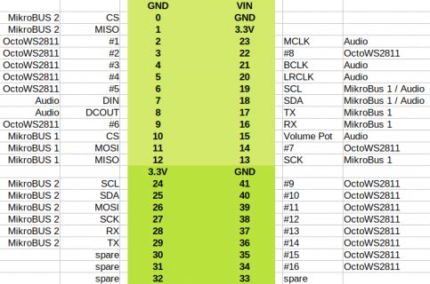

For a project I searched for an adaptor board, similar to the OctoWS2811 Adaptor but with more channels. There are also some other features I need, like audio and a USB host connector.
There are different adaptors available for everything, but not a single board with all the features. So I decided to design my own carrier board for the Teensy 4.1. At the moment I'd like to integrate the following features
This is the pinout I cam up with. Some features will also be supported by the Teensy 4.0.
Before I start with the design I wanted to get your opinions. Is something like this already available?
Are you interested in a carrier board like this? Do you see any problems with my current pinout? What other features would you like?
Regards, Ibis
- USB Type C for Power and Programming
- DC Jack for Power
- USB Type A Host Connector
- Ethernet (RJ45)
- 16-Channel OctoWS2811 (4x RJ45)
- 2x mikroBUS Connector (for MikroElektronika Click Boards
- Audio Interface (SGTL5000)
