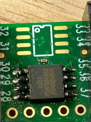

Hello,
I received my brand new W25Q128JVSM soldiered on my teensy4.1.
I tried the LittleFS file test ListFiles to initialize flash ship with a few modification (chipSelect, SPI or QSPI) and the only result it gave was 'initialization failed!'.
I think my welding is good.
So the problem may be I didn't understand how the library and test works.
I'm sorry if my problem looks easy to solve but do you have some clue or file for init/test for me, it would really help beaucoup I don't know at all what to do?
That picture shows lots of FLUX and garbage around the connections. I would carefully wash the board getting that cleaned off - here I use 90% Isopropyl and a light toothbrush to get residue off the PCB and around the pins - then get it dry before repowering. Water may work based on the flux involved? or 70% alcohol if that is all that is on hand - but won't dry as fast. I don't have an oven or anything to dry - I hold in hand and heat with a hair dryer hot air making sure no fluid trapped in the SD socket or on either side.
> also looks like something sitting between pins 1 and 2 on the marked corner? Make sure there are no pin to pin shorts

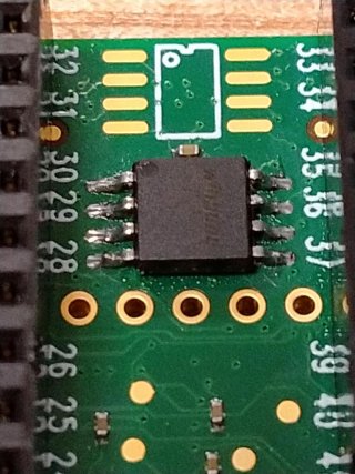

But it don't works. I tried with a W25Q238JVSQ on a other teensy and I was able to initialize flash, create, write and read files, so I will work on it for the moment.
The next step for me was to use MTP_t4 (https://github.com/WMXZ-EU/MTP_t4) to have a fast access to my files. I know this is a little bid far away of my initial problem but it seams this will be out dated when TD1.54 is available. So do you have any idea when a stable version will be available?
@Concombre - That does look much better and no signs of shorts between pads.
All but one of the pads between that chip and the open PSRAM pads are common - only the CS pin is unique. You might check the resistance between each like open pad and place the other probe on the top of each pin leg in turn near the chip body to see that they all make a low resistance connection - the one that is CS will read fully open as they have no connection, the other seven pins should end up showing connected less than an ohm.
If that shows any weak connect Perhaps doing a reheat/reflow of the solder to of each pin/pad: hot iron onto pad against pin solder and into the pin until it goes liquid with both parts heated. Here I'd do that with a bit of flux paste on each as it would help with the melting and reflowing in less time for a better job. That would mean perhaps a quick clean and full dry again.
If the chip came from a real distributor and wasn't damaged before or during soldering when fully soldered it should of course work. I've probably soldered a dozen of those FLASH, PSRAM and even the WSON FLASH chips with only the edges to get solder on without any failing to work - and I'm not well versed in soldering.
