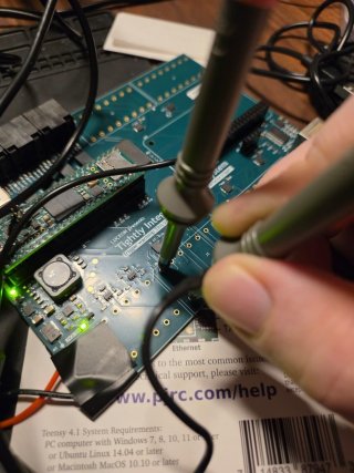

We are running into a recurring issue where our Teensy 4.1 boards are suffering fatal hardware damage after running for a period. We have destroyed 4-5 boards under the exact same conditions, so this is not a one-off defect.
Background & Setup:
Power: 5VDC supplied via VIN pin through a 24VDC to 5VDC buck converter.
Function: Running firmware that generates square wave triggers via several PWM pins.

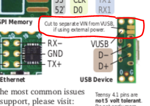

Connections: The PWM pins are hooked up directly to an oscilloscope. USB is also connected. Teensy got damaged with VIN/USB power bridge cut as well as intact. It doesn't seem to matter if we cut it or not
I/O: There is no external voltage applied to any pins. We have a few input pins pulled up to 3.3V using 1k resistors, which we have verified and measured multiple times. There is no external input attached to those input pins.
Environment: Home lab on a rubber mat powered from 24VDC to 5VDC buck converter
The Problem:
Everything looks great on the scope for the first few hours. However, after running continuously for about 30 hours, the Teensy dies. It gets physically damaged at the chip level - it becomes completely unresponsive and will not start again after a power cycle.
Troubleshooting so far:
There is no apparent overvoltage or wiring issue that we can see with the setup (image of the setup attached).
Any help is greatly appreciated.

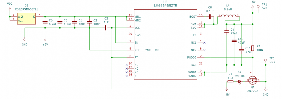

Were all the units connected to the same buck power supply? If so, suspect the power supply. Have you inspected the power supply with a scope before and after the failure?
For what it's worth, you didn't show your setup, only a partial schematic. If you can please post a picture of the setup. Also, what is the part number of the power supply are you using. What's it's overshoot spec? Is the power ever cycled? Did it fail after a cycle, or while continuously running? Does it recover if you press the reboot button?
Hard to make further suggestions without more details.
What 24VDC to 5VDC buck converter are you using ? Could be transient from the converter.
Post a photo of your setup.
Thank you for your response. This has happened both on a buck converter like this one (LM65645RZTR) as well as from a 5VDC "wall adapter" which is plugged into the micro-USB port. It doesnt seem to matter how I power it.

@davidus: from the picture in your original post, it appears that you are providing 3.3VDC from an external power source (the schematic seems to indicate that the 3.3VDC pin on the Teensy is not connected). Where is the 3.3VDC supply coming from ?? if/since you seem to have multiple power sources, do you have all grounds (Teensy, 5VDC supply, 3.3VDC supply, etc.) connected at a common point ?? What else is on your PCB that may be either connected to your Teensy and/or leaking unintended power into your Teensy by some sneaky path ?? And, just a reminder that the T4.x is not 5VDC tolerant . . . all inputs must not exceed 3.3VDC (looking at all of your T_xx connections). Just guessing at this point !!

All grounds are common. The 3V3 comes from an LDO which gets power from the 24VDC to 5VDC buck converter which powers the Teensy.
There are two things on the PCB - ethernet socket for the teensy, and then RS422 transmitter which takes the PWM signal from a the teensy pins and turns it into differential signal. This does work as confirmed by a scope, but again, it magically kills the teensy after several hours.
All input pins are disconnected, but are pulled high to 3.3V rail. Output pins generate square waves and put that into RS422 transmitter. That is it. It's a very bare setup.

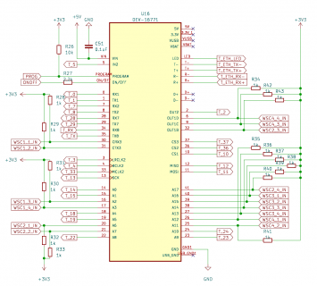

@kd5rxt-mark , I only power the teensy via 5VDC. All the 3v3 pins on the teensy are floating; nothing is applied to them.
As @Fluxanode said, the 3V3 rail is for other ICs (namely the RS422 transmitters).
Schematic is attached.

Have you measured the output voltage on the 5VDC wall adapter ? I've seen some are high as 5.2V
Would really like to see a complete schematic of the board. Can't see the 3.3v regulator at the moment.
If the 24v input is not on and you have the 5v USB connector then you are back feeding the 5v to the LM65645RZTR. Normally you would have a diode such as the BAT54 connected from the LM65645RZTR to the 5v line to prevent back feeding.

You can cut a trace on the Teensy to prevent back feeding. Both, cut an uncut, resulted in the Teensy dying over some period of time.

That's a lot of low resistance pull-ups. The total sinking current may be exceeding the Teensy's limits.

If you don't want to do the surgery on the Teensy, then buy one of these - https://www.amazon.com/PortaPow-Cased-Power-Blocker-Single/dp/B094FYL9QT/ref=sr_1_3 I use them all the time to keep my USB from providing the power into the main boards on them.
You can also get USB hubs with per port power switches (sometimes described as enabling / disabling the port but they do that by turning the power off). Handy in this situation with the added benefit that for usb powered devices it gives you a method of resetting them that doesn't require you to pull cables out.
This 3.3V power may be turning on too early. See Power Up Sequence on the bootloader chip page for details.
1K pullup resistors to I/O pins should not destroy the hardware, but you can easily get Teensy stuck if current feeds through the I/O pin ESD protection diodes and attempts to power up any part of the chip too early. If this happens, the hardware becomes unresponsive and appears to be damaged, because you can't easily tell the difference unresponsive stuck on improper power up sequence and unresponsive because hardware is physically destroyed. But if you unplug Teensy from your PCB (nice that you used sockets) and power Teensy by just a USB cable, it might suddenly come back to life, which would tend to confirm a power up sequence issue.
If this turns out to be the problem, there are a couple possible solutions. You could connect the pullup resistors to 3.3V power generated by Teensy's LDO. Alternately, if your LDO chip has an enable pin, you could wire it to Teensy's 3.3V power, so your LDO stays off until Teensy has 3.3V power and will be ready to see the pins pulled up.
As you can see in the Power Up Sequence, step #6 is where the 3.3V power turns on. You really want to avoid driving the I/O pins before step #6.
