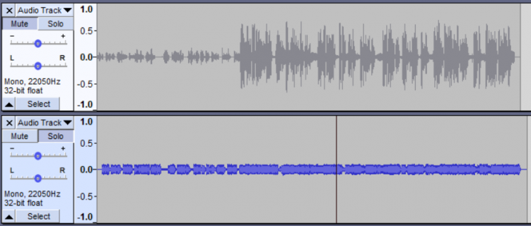

Hello,
I am currently trying to create an 8-band equalizer with amplifier that uses 3.5mm input/output. I have attached a picture of my setup as well as my code at the end.
Currently, I am facing two problems. The first is that when testing a single band of the EQ, at higher gains I get really bad noise. Here is a sample of 1760Hz pure tone with the 1k-2kHz band being set to +10dB, then +45dB, then +30dB.
http://sndup.net/cgrp
Finally, when using the equalizer with a sample gain profile or from a friend who uses hearing aids, there is massive saturation going on. You can see this in the picture below:
The top is the raw audio and the bottom is filtered.
Can anyone shed some light as to what is going on?
https://i.imgur.com/m9Ce2IA.jpg
