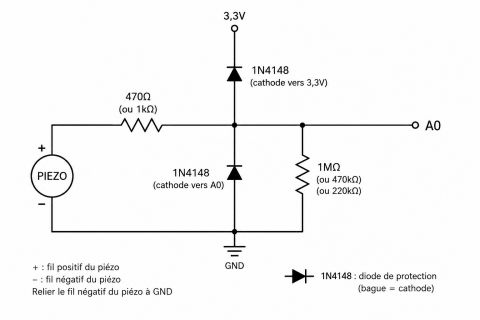

A little background about my experience:
I am a beginner, but I am determined to learn! So far, I have only built prototypes for music/MIDI projects using an Arduino Leonardo.
I eventually ran into the memory limitations of the board (especially when using ToF sensors), so I decided to switch to a Teensy 4.1, which seems to be ideal for audio and MIDI applications.
My current project is to build several piezo pads that will trigger sounds in Ableton Live via MIDI.
I understand that the Teensy is more sensitive to the voltage spikes generated by piezo sensors, and I would like to avoid making any mistakes.
I have done a lot of research, and before starting my tests, I would like to know if the following circuit is suitable for this application.
Thank you in advance for your help.
