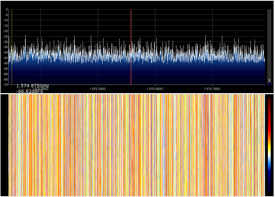

Just an observation (not your problem), the sparkfun GPS is supposed to flash its LED with a good GPS lock, but with the T4.1 running the NTP/GPS server, it sometimes stops blinking for a while. The GPS is still emitting NMEA but it may be using its internal clock ? I actually had one mbed eval board that would never work with that GPS, because of high frequency interference maybe?? Any how it looks like the T4.1 running native ethernet affects GPS signal ???

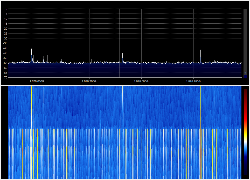

All sorts of things can interfere with GPS signal. It's a very weak signal when it gets to your receiver. The satellites overhead are moving very quickly, so if your antenna can only see part of the sky, there will be times that the module will lose lock and stop blinking till a new satellite moves into view.
For an example of noise, I have an SBC based on the rk3328 processor with USB3. When I plug something into that USB port, it makes a lot of RF noise around the GPS frequencies:
Normally the noise is much lower:

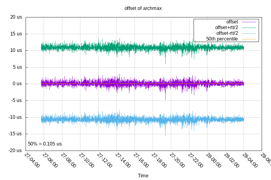

I'm using chrony with hardware timestamps turned on to test NTP on my other systems. Not every NIC supports them, but my Intel NICs do. To check if you have support (the SOF_TIMESTAMPING_TX_HARDWARE and SOF_TIMESTAMPING_RX_HARDWARE are important):

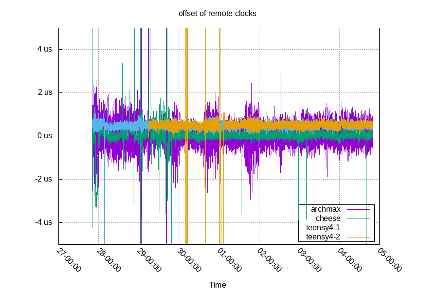

I added an offset and drift plot to post #3
This is amazing work, thanks for posting this! I noticed the 1588 hardware features listed for the T4.1, and I wondered if they would be supported in some way.
On the first graph in your first post "Phase offset: Teensy vs PPS" ...if you are taking a PPS signal direct from a GPS, especially with a non-ideal antenna placement, is it possible most of that jitter is actually from the GPS PPS output granularity plus its receiver slipping in/out of phase lock as each sat signal fades in/out? I assume it might look quieter if you took the reference PPS from a stable GPSDO ?
The phase offsets happen at the same time as the frequency changes, which has me thinking that my synchronization code needs some tweaking. I suspect PPS from a GPSDO wouldn't change much unless the system clock also came from the GPSDO.
I would expect almost any un-corrected crystal oscillator to have better short term jitter than a raw GPS PPS signal, although of course worse over some longer term, but when the oscillator is controlled in a PLL then I don't know. I have a GPSDO fed from a roof-mount antenna, and a Teensy 4.1 and am curious about this. To try it out I guess I also need some kind of ethernet adaptor for the T4.1; anything else?
Sure, the short term phase noise from the crystal will be much lower than the GPS. But I think what is causing the larger offsets are the frequency change due to temperature changes. It would be worth testing covering the teensy's crystal to lower the convection. Looks like it normally wanders around 100 parts per billion over an hour in my setup.

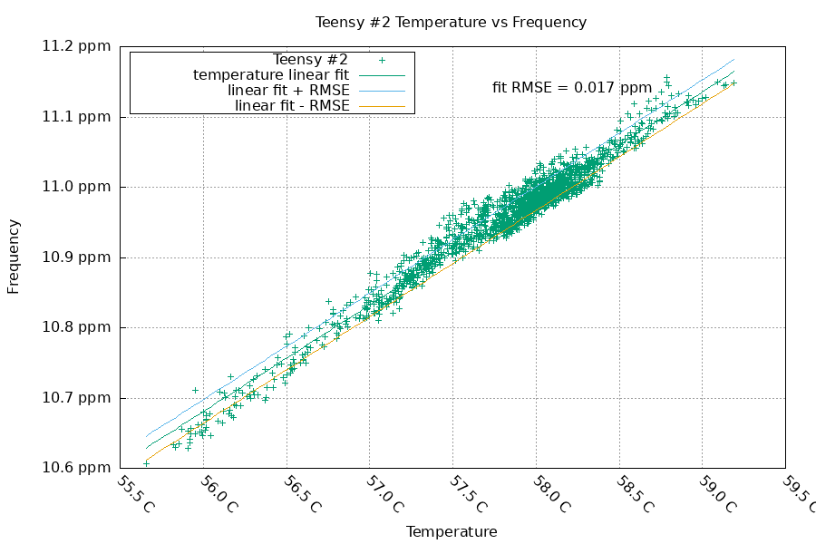

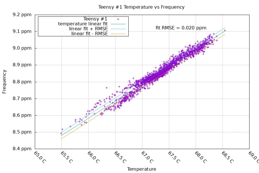

You could print T4 temperature (tempmonGetTemp() float degrees C) in your table printing in updateTime() to track drift and temperature.

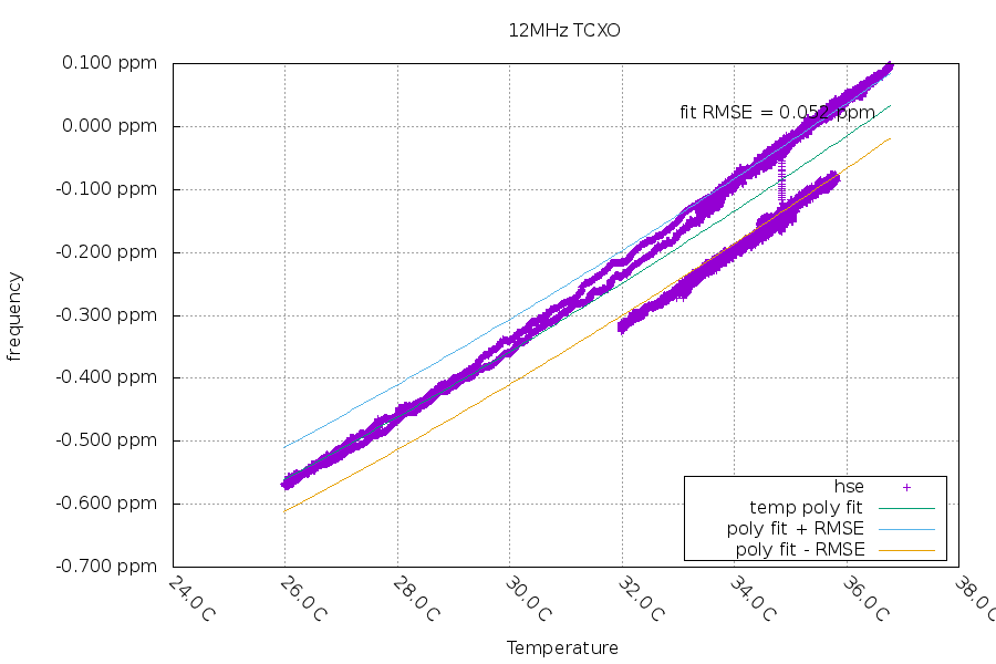

I can't really see the temperature cycles in the MCU temperature data, but a separate I2C temperature sensor (Si7021) does reveal the HVAC cycles. Roughly if temperature changes 1.0 C then MCU frequency changes 0.067 ppm
Here are two plots showing change in drift versus temperature. PPS samples every second. HVAC cycle about 500 seconds.
(The active antenna also fixed the GPS signal problems that I was seeing on mbed board)

I purchased active antenna and placed it on windowsill attached to my adafruit ultimate GPS, and i no longer lose lock. Settings were 9600 with GPS_USES_RMC. offset/drift look good with GPS PPS and disciplined T4.1 clock and 1088 NTP server. I also tested a u-blox NEO-M8U GPS with the external antenna and the 1088 NTP server. I added T4 temperature to table output. Offset and drift plots below

I've collected this type of data in the past for other crystals, so I'd like to redo the plots below for the teensy:
32khz RTC crystal:
12MHz TCXO:
I let this run for 5 days, and these are interesting results. I have two different Teensy 4.1 boards running this code.
Temperature vs frequency over 256 second intervals:
Just using a linear fit gives a pretty good result for this temperature range. If the room these are in had a larger temperature range, a quadratic equation might fit better.
They're within a foot of each other and running the same code, but one is showing +10C from the other. They're plugged into different USB hosts, so maybe some heat is coming from the hosts. But I also assume there's some temperature measurement offset error from tempmonGetTemp() that varies from teensy to teensy.
This suggests that adding frequency estimation from temperature measurements to the control loop might be worthwhile. At the very least, it'd be good for keeping the time while there's no PPS from the GPS.
