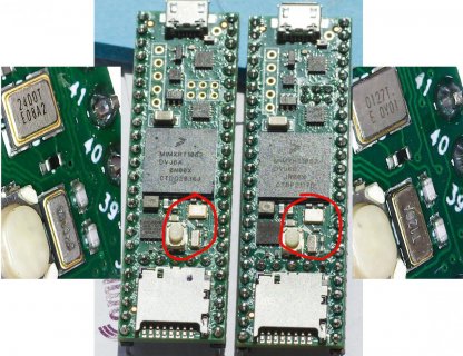

Interesting... a 3rd T4.1 and this time I get the ticks evening out at about 999990 ticks, while the first two were both around 999960... This one was bought at a different time. I will try them all in the same board with exactly the same build and compare - but I suspect some of the T4.1s I have are significantly out of spec with the crystal.
(Is there a serial number in a Teensy I can extract?)
Cheers - N
In fact, checking under a microscope seems to show both the 24Mhz and 32.768kHz crystals are at least visually different on the two types of T4.1 I have that are giving in and (apparently) out of spec crystal performance.
The good (10ppm) Teensy is the one on the left with the "2400T" 24Mhz crystal... The one on the right (and another - not shown) Teensy both have the other crystals and stabilise at about 40ppm off...
Is this a known issue with some T4.1s? They were obtained from Sparkfun - any chance they are counterfeit? I haven't seen a counterfeit since the first 3.2 I bought

The Ethernet MAC address and USB id are unique. The MCU stencil has a "batch date", me thinks, (shown in your closeup photo), but your concern is with the crystal.
PRJC builds all the T_4.1's distributed by others like Sparkfun. The shown items are of different builds as one seems to be the early "A" 1062 and the one on the right s seems to indicate it is a newer/current "B" version of the NXP supplied 1062 MCU.
In these times with limited part availability, it is possible alternates are sourced to allow production. This is the first apparent notice of variation in the crystal showing this.
I can say the latest PJRC Supplied Beta T_4.1 with a "B" MCU shows a 2400T crystal in place. Other recent T_4.0 and 4.1 boards (Beta and other on desk) show the "A" MCU with the 2400T crystal.
Each Teensy does present a unique Serial number - there is code in CORES and the forum that can expose that to print, and it is presented over USB during Host connection and TyCommander displays that.
Thanks. It's not the end of the world as anything less than perfect needs to be compensated for in my application - I need ms synced separate units, but might be worth noting somewhere on the specs somewhere as it's about double the published tolerance in less accurate unit.
I have no reason to believe it is the MCU though so probably not worth bothering getting the serial unless someone would like a record of the units with the less accurate clock.

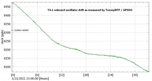

Here is a plot of my Teensy's onboard crystal drift during 34 hours after a restart. (At least, I think this TeensyNTP-reported value is the onboard clock drift). Total change over that time was less than 0.4 PPM so that looks reasonably stable to me. The data plotted comes from running
curl -s [url]http://teensy-ntp1.lan/state.json[/url] | jq ".clockPpb"
once every minute. I have the T4.1 sitting in a 8" hollow concrete block which is inside a sealed styrofoam box, to reduce the rate of temperature change on the board. The PPS input comes from a GPSDO. The +5V power to the Teensy is just from a cheap wall-wart, so voltage stability is another variable.
Here is a plot of my Teensy's onboard crystal drift during 34 hours after a restart. (At least, I think this TeensyNTP-reported value is the onboard clock drift). Total change over that time was less than 0.4 PPM so that looks reasonably stable to me. I have the T4.1 sitting in a 8" hollow concrete block which is inside a sealed styrofoam box, to reduce the rate of temperature change on the board. The PPS input comes from a GPSDO. The +5V power to the Teensy is just from a cheap wall-wart, so voltage stability is another variable.
That's a nice graph, low amounts of short term change as well.
