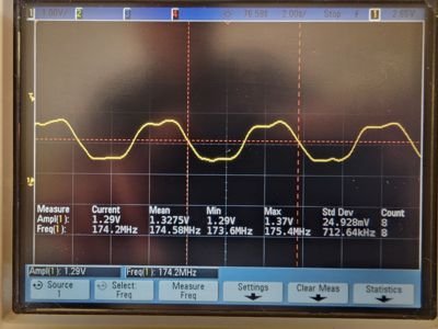

I found a thread in Internet to overclock the MCU on Teensy 4.1 board. Even they say, "with a heatsink or active cooling" you can reach up to 1 GHz (1000 MHz, compared to 600 MHz nominal),
it is not really true.
What I have found:
  1. faster as 600 MHz degrades GPIO signals (their peak level, not 3V3 anymore)
  2. too fast - and it bricks the board!
The faster you set MCU core clock - the GPIO signals degrade! They do not reach anymore the 3V3 level (examples below). The peak amplitude of pulsing a GPIO is degraded!
Starting with 900 MHz MCU core clock - the flashing (bootloader) via USB becomes flaky (unreliable).
With 1000 MHz core clock - it was almost IMPOSSIBLE to flash the board again: the USB is so flaky, the bootloader, USB flash is almost NOT working anymore!
(it took me so may trials just to recover the board!)
The overclocking affects the bootloader, USB...!
My conclusion:
It does not make sense to try overclocking the MCU:
with 600 MHz it seems to be already right at the max. performance. Otherwise, signals become degraded (not reaching nominal high level voltage anymore) and the
flash loader, USB, ... starts getting unreliable.
The max. clock speed I could find able to set: 620 MHz (resulting in 618 MHz effectively).
(independent of cooling: based on signal integrity and reliability)

But how is the signal integrity actually. It might be worthwhile posting an image of your experiments (from digital oscilloscope) at the various measured voltage and clock settings.
Not doubting your experience or what you have witnessed, but my own practical experience differs widely from you've detailed. Eg; I run multiple Teensy 4.1's at 720mhz and 816mhz 24/7 - all using 20+ GPIO pins operating at a minimum of 20mhz. One device GPIO is running @ 60mhz, but has reached 120Mhz stable. All have two heatsinks (copper, one large with fins to draw the heat on to the a smaller cover plate) attached via 3M double sided thermal sticky tape.
IIRC, don't the GPIO pins also have a "drive level" configuration ?? Did you try increasing the drive level ?? Since that should directly affect the rise time of the GPIO signals, very likely the overclocked shape of the output waveform will improve. Of course, there will still be a maximum limit, but probably not as low as you have experienced/reported.

But I would like to comment regarding some of your conclusions.
No matter what speed your program runs, the bootloader always runs at 396 MHz.
When you click Upload in Arduino IDE, entering bootloader mode depends on your code running at overclocked speed to notice the USB request to enter bootloader mode. Like everything else with overclocking, it can become unreliable. But you should not conclude Teensy is bricked only because you see the error in Arduino saying Teensy didn't respond and you need to press the pushbutton. That error is the expected behavior when a program (even without overclocking) crashes in any way where USB communication no longer works.
Expect to have to press the Program pushbutton on Teensy when things go wrong.
About the GPIO voltage conclusions, please understand your code is generating extremely short pulses! The pulse width varies with CPU speed.
void GPIO_testSpeed(void) {
#if 1
  /* this is 10x faster! assuming, this code runs on ITCM */
  while (1) {
    GPIO_setOutValue(32, arduino::HIGH);
    GPIO_setOutValue(32, arduino::LOW);
Even if you have the pin set to fast slew rate, when running at high speeds you may be trying to change the pin faster than the transistors inside the chip are able to actually change the voltage. They are only capable of limited current to charge & discharge the capacitance of the pin and any test gear you've connected. Overclocking the CPU doesn't change anything about the transistors which drive the GPIO pin.
You should add a delay, even just several NOP instructions (enough to fill the M7's pipeline to be sure to have an effect), so the pin's voltage is able to settle. I'm pretty sure you'll see the GPIO voltage problem you experienced is mostly due to the pins not able to physically change voltage as fast as your overclocked code is running, and with delay for the signal to settle you'll probably see the GPIO voltage remains fairly consistent even up to 1 GHz.

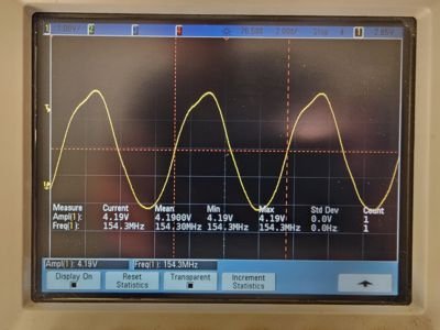

Update:
I have a heat sink (cupper) on MCU. temperature is fine (maybe 40C).
The drive strengths (DSE) does not matter so much for speed (more related to external impedance, I have scope with 1 MOhm probe only (no load)).
The Slew Rate (SRE) and Speed (SPEED) matters more for maximum speed.
BTW: the drive strengths is set already to maximum (DSE(7)) in LIB functions.
Anyway, based on the datasheet for MCU: with proper SRE and SPEED config - the maximum possible GPIO speed is 200 MHz.
Here two scope pictures:
1. 700 MHz MCU core clock, full speed GPIO: 174 MHz - but signal amplitude is degraded!
2. 620 MHz MCU core clock, full speed GPIO: 154 MHz - signal amplitude is OK
All fine, it was just a test.

I suspect you are seeing ringing in your 'scope ground wire, and/or bandwidth limitations of your 'scope, not the real voltage on the pin. These are fast logic edges that require a low-impedance probe and GHz BW 'scope to see accurately.
The amplitude accuracy of a scope input section often goes to pieces when close to its cut-off frequency as the response is peaked to extend the usable bandwidth, and a 10:1 passive probe also has anomolies at the end of its range too.
