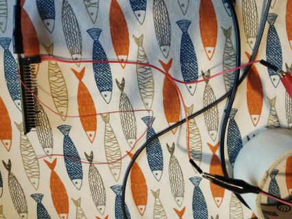

I conducted tests with the following setup (see picture):
  1. Teensy 4.1 powered standalone at 5V via the Vin and GND pins using a stabilized power supply.
  2. USB connection to PC with a cable that only carries D+ and D- signals, along with GND (with +5V from the PC removed).
  3. Adafruit IC PSRAM 64Mbit SPI 133MHz 8-SOIC (Digikey code: 1528-4677-ND) soldered onto the smaller bottom pad.
  4. Winbond W25Q128JVSIC flash (Digikey code: W25Q128JVSIQ-ND) soldered onto the larger bottom pad.
  5. Firmware: A simple program that checks the presence of both PSRAM and Flash (attached to this post).
Observed Behavior (I have the video but it is too large to be attached here):
  1. The board draws 100mA for a few seconds.
  2. After some time, the current starts to increase gradually up to 140-150mA.
  3. Eventually, the current fluctuates unpredictably, jumping between 120mA and 140mA.
I conducted the same test using a Teensy 4.1 without PSRAM and flash, and the current consumption remained perfectly stable at 100mA.
When I mount the Teensy on my custom board, using a dedicated firmware, a similar but slower behavior is observed:
The current starts at around 150mA and gradually rises to about 220mA.
I suspect that this phenomenon is due to the quality of the PSRAM chip and may be temperature-related, as the behavior seems to worsen with time.
I soldered a brand new flash chip onto a new Teensy and it is working absolutely fine absorbing a constant current = 106mA. I'll add the PSRAM and see what happens
I added the PSRAM. The board drew approximately 107 mA for about half an hour, during which the Teensy successfully recognized both the PSRAM and the flash memory. After that period, the current gradually increased to around 130 mA, and the flash memory was no longer recognized. The issue definitely originates from the PSRAM. I have contacted DigiKey to inform them of the problem.

I'm running a quick test here on the board with both chips. Monitoring current with the simple display on my bench power supply.
Here's a photo when I started. The current has increased slightly over about an hour, now showing 0.111 and sometimes 0.112.
