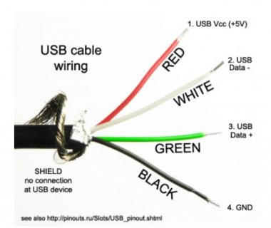

I am trying to use a Teensy 4.1 board by connecting it to an external PCB. I cut the original power connection from the underside and am now supplying 5V power from the PCB. To do this, I cut a USB C to USB A cable and used only the +5V and GND lines, leaving out the ‘data +’ and ‘data –’ lines.
When I power on the PCB in this setup, the Teensy continuously blinks with a red light and does not operate properly. However, if I briefly connect the Teensy to my laptop through its micro USB port and then disconnect it, the board starts functioning normally again. (Didn’t need to do anything on my laptop just connected it and disconnected it after few seconds)
In this case, I would like to know whether the issue is with the Teensy board itself, or if it may be related to the power supply, PCB, or code.
