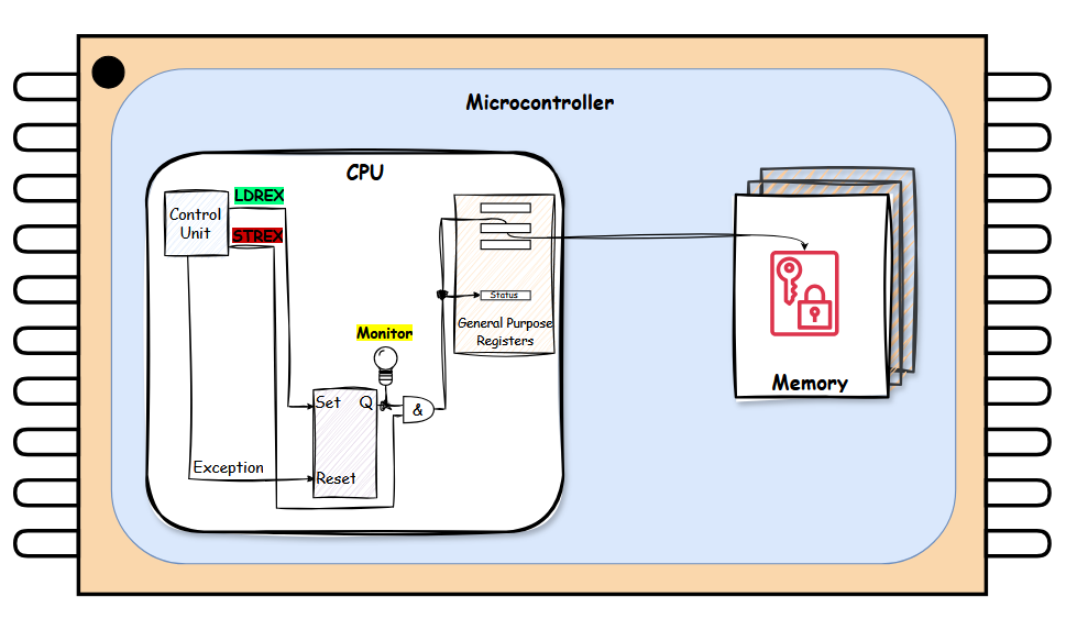

I’d bet that the C++ primitives, eg. std::mutex and the atomics (and semaphores from C++20), use these instructions.
You can't use the C++ threading primitives on Teensy. They have to be implemented (e.g. like all the other stuff provided by newlib) by a kernel since you can't block on a mutex, semaphore, etc. without some sort of context/threading system including an idle thread that can always run when everything else is blocked. Newlib doesn't attempt any of that so they throw a compiler error.
The atomics are available and do use ldrex/strex, although they also include extra steps (emitting barriers) designed for multi-core CPUs that are unnecessary in this case.

It's easy to do it for a single value (that's what ldrex/strex are for) but significantly harder to atomically update multiple values.
