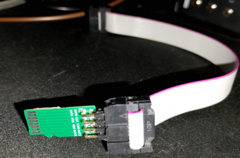

Hi! I made a simple SD card extender board+cable in order to give easy access to the SD card when the T4.1 is mounted behind a Eurorack panel,.
I've not done anything nearly as clever as stg reports, simply routing all the pins over uh-ohan IDC cable, but it seems to work fine when used as an extender on other devices, eg a RadioMusic I've used for testing. But when connected to a T4.1 the extender doesn't work -- similar symptoms as reported here (timing out when attempting to access).
Did you ever have any luck with this, stg?
What's the alternative if this can't be done with the built-in SD card reader on the T4.1? Use an external SPI SD controller perhaps?
Can you show a photo? I’m guessing it’s just not good enough for SDIO, so yes, an alternative would be an SPI SD.
Just this at the Teensy end. The other end connects to a header on PCB that connects all the pins up to a PJS008U-3000 socket

If I were to use an external SPI SD controller, then I guess the best thing to do would be to send the SPI over the IDC from Teensy, have the controller and the socket at the end of the IDC, rather than sending all the SD pins over the IDC?
Although I suppose there's a chance that an external SD controller would have no problem being extended over the IDC, since it seems its only the built-in Teensy 4.1 that may have this issue..?
I meant you might be able to send the SPI signals further than SDIO, but maybe not that far. Hopefully more hardware-savvy folks will comment, but for T4,0, for example, what I remember seeing is usually a piggyback board, so the signal distances remain very short.
SD using SDIO protocol on the built in SD socket uses 50 MHz clock.
SD over SPI defaults to 16 MHz, but you can configure slower or faster speed. Slower clock is (probably) more forgiving of lengthy wiring.
Adding series resistors on the non-power lines might help. Values between 33 to 100 ohms are probably in the right range.
You might also look at the power quality. Does the socket at the end of that cable have a good quality ceramic capacitor between 3.3V and GND? If you add a capacitor, don't go crazy with a huge value. The high frequency response matters much more, so a smaller capacitor with X7R or X5R ceramic (eg, about 1uF capacitance) is much better than a larger aluminum electrolytic type.
