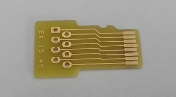

I have wondered whether an SD card extension cable like this could be butchered to bring out the SPI2 pins (SCK2, CS2, MOSI2, MISO2) without having to solder onto the QSPI memory pads. Anyone tried that?
Perhaps such a PCB?
Paul
Looks good.
