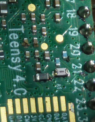

Where is the 470R resistor on 4.0 if I want to lift it off?

Can you help me localise the 470R resistor?
To avoid 5V abuse would a 33k / 66k divider be suitable on inputs?
This is a bad idea. Something is clearly wrong. You're (probably) only going to make matters worse and more confusing if you start desoldering parts!
But if you really want to go down that path, on the Teensy 4.0 page scroll down to Technical Information and look for "Schematic" and "Component Locations". You'll see it's R1 on the schematic and you can find R1 location the back side with the Component Location diagram.

while looking at R1 I noticed C5,C13 seem damaged.
