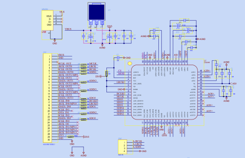

TEENSY 4.1 to handle 2 X CS42448 possible?
"The French Alibaba listing doesn't seem relevant to the CS42448 board,"
yes it is if you select the 4th from the left,it's named Couleur: CS42448 and see its picture,the same as posted in this thread.
  • AD1452_DSP_PCB及接口说明.pdf
Urgh ... I hate these sites where multiple different items are listed under one heading. That's most of them, these days, including eBay and Amazon...
OK, so we have a PNG schematic (not from the AliExpress page, as far as I can see) which is just barely readable, and contains significant errors. For example, based on the PCB layout, AD0/CS is connected to IC1 pin 8 (named CS) and CN3 pin 9 (incorrectly named SS). CN3 pin 6 is labelled EX_RST on the schematic, which I can't find anywhere else on the schematic, though the PCB layout suggests it is indeed connected to the /RST pin of the CS42448.
It'd be interesting to track down the source of the PNG, as it looks like a screenshot of another document, maybe even the schematic CAD with all the components selected. Better resolution would probably help, but removing the highlights and having it error-free would be better!
Still, it looks as if you have access to all the pins you need, and even a 3.3V supply (U1) for the I²C pull-ups.
It occurs to me that you will need to be a bit careful about powering up the Teensy and the CS42448 board at the same time. In particular, the Teensy has quite strict power sequencing, so you should not connect the 3.3V rails together!

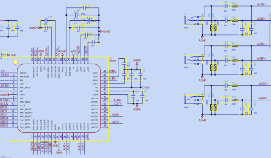

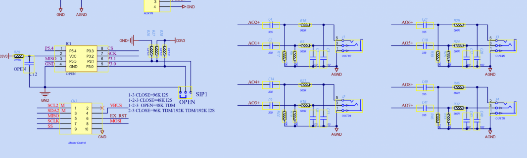

I'm sorry for the bad viewing,it's a 2Mo pdf,i can't attach it,it says it's too big,i give you 3 extended resolution pictures:

You're completely right,it will be a mess with all power supplies to be connected together if i feed the teensy and cs42448 at the same time!!
I barely can feed : teensy 4.1 + display 7" 8875 + cs42448 together from the teensy ,i have to do it from the cs42448 usb,the capacitors are bigger and i think the 5v->3,3v converter much efficient for powering.
Thanks for that. I've re-assembled the 3 PNG files into one image and removed the annoying pale blue background, which I think has made it a smaller file, too. I also annotated the Master Control pins.
Nice job done, my eyes prefer the blue color because the yellow superposition,it's a question of taste :)

But i can't see any IC1 soldered on the PCB,only a drawing ,isn't it strange?
Pretty sure IC1 is intended to be fitted, along with R26, R27 and R28, to allow configuration of the board by setting jumpers on SIP1. It's hinted at on the schematic you posted...
The shematic you certainly looked at, better than me:)
Thsi cs42448is intended to be sandwiched with the UDAU1452,but only one cs42448 is to be wired,so maybe 2 cs42448 could make
a conflict with the I2C bound to UDAU1452
