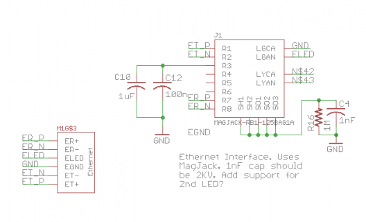

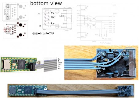

Hi, I just got my DigiKey parts for the ethernet dongle for my Teensy 4.1... but haven't received my OSHPark order yet.
I wanted to wire up the jack to the cable, but I'm not clear on the connections needed. I searched and searched, but didn't find this clearly defined anywhere, and will need to resort to using GIMP on the few OSHpark images, as well as the MagJack pinout (which uses a different naming convention).
If there's someone that can quickly provide an existing schematic for my needs, it would save me some time.
Thanks,
-Nathan
Top of PCB view
https://www.pjrc.com/teensy/beta/k41_ethernet_placement.png
https://644db4de3505c40a0444-327723...kcdn.com/68a412d2881be6c68eef512d913aa1e4.png
Bottom of PCB view:
https://644db4de3505c40a0444-327723...kcdn.com/1c4fd10914f99882bc2c8eb7fe68119a.png
Recommended MagJack (RB1-125BAG1A) data sheet:
https://media.digikey.com/pdf/Data Sheets/WIZnet PDFs/RB1-125BAG1A_ApprovalSheet.pdf
