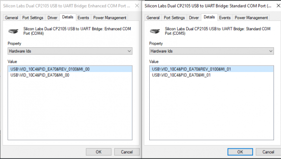

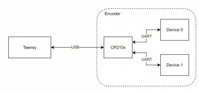

I've been having an issue using the USBHostt36 library to interface with a specific serial peripheral inside of an existing product. The product has a CP210x USB to UART Bridge between the USB port and the serial port. I only care about bidirectional communication with Device 1 in the diagram below.
BACKGROUND
When I plug the encoder directly into a pc running the CP210x USB to UART Bridge VCP Drivers, I see two com ports appear, an Enhanced COM Port and a Standard COM Port. The Standard COM Port is the UART connection to Device 1.
Sending commands to the Standard COM Port (Device 1) using Tera Term/Cool Term/Putty yields the expected return message.
I can also send commands to the device through a simple Python script and it was working similarly fine.
WHAT I'VE TRIED
I tried using the native USB port to do direct Serial using Serial.print. No luck.
I tried using the USB Host cable. This is my latest code. Again, not working. I've tried changing the argument for the USB Serial object, but that still doesn't let me access Device 1. I can, however, read the boot message of Device 0.
WHAT I'VE TRIED
C++:
#include <Arduino.h>
#include <USBHost_t36.h>
// USB Host Setup
USBHost nUSB;
USBHub hub1(nUSB);
USBSerial serial1(nUSB);
USBSerial serial2(nUSB);
while (!Serial); // Wait for serial monitor to connect
nUSB.begin();
serial1.begin(115200); // Set baud rate for the first UART device
serial2.begin(115200); // Set baud rate for the second UART device
Serial.println("Teensy USB Host Serial started");
nUSB.Task();
if (serial1.available()) { // Check if data is available on the first UART
int byteFromDevice1 = serial1.read(); // Read the data
Serial.print(char(byteFromDevice1)); // Print data from Device 1
if (serial2.available()) { // Check if data is available on the second UART
int byteFromDevice2 = serial2.read(); // Read the data
Serial.print(char(byteFromDevice2)); // Print data from Device 2
if (Serial.available()) { // Check if data is to be sent from the serial monitor
char c = Serial.read();
serial1.write(c); // Send received character to Device 1
serial2.write(c); // Send received character to Device 2
