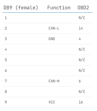

I have my CAN board connected to a 9 pin D sub/serial connector
Did you connect it according to this pinout? (no need to connect VCC)
Paul

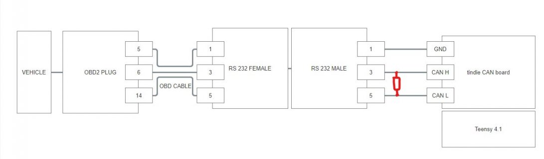

Thanks again all. To answer the questions:
Please see attached screenshot on how I've got it wired, with the pins etc.
@jimmie - where in this would I need to attach the resistor please? would it be between pins 3 and 5 on the RS232 male plug?
I'll try swapping the CAN lines and see if that helps.
@PaulS - My DB9 pins are different to the table you posted (I had to use the premade cable). On the OBD connector, mine shows pin 4 is vehicle ground and pin5 is signal ground. I'm using 5 instead of 4. Should I try and switch that?

@Taymar
I am not using an RS232 plug but the resistor needs to be between the Can H and Can L lines on the Teensy side.
In my installation, I am using a Waveshare Can module connected to my Teensy. So the resistor is between the Can H & L lines of the Waveshare module.
The bus needs 2 x 120ohm termination resistors. You should measure 60ohms when fully connected & powered down.
Fully connected to the vehicle? I measure 120 ohms between the high and low wires at my RS232 plug, without the OBD section connected.
I measure 32 MegaOhms between either can wire and GROUND.
When fully connected to the vehicle you should see 60Ω. Your measurement of 120Ω is correct for a not-connected OBD plug.

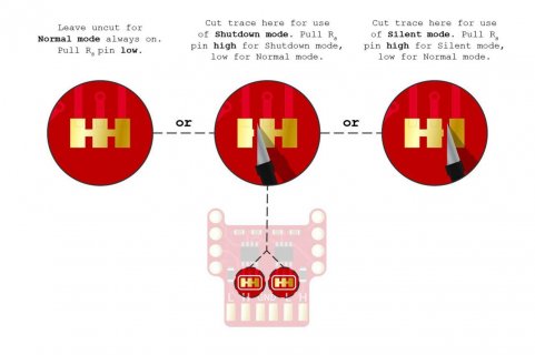

Thank you, please excuse yet more ignorance from my side - the CAN device has some traces you can cut to change the configuration. It looks to me like these are more for setting read/write/read only mode etc, but also sounds like they pull certain pins to ground. Would cutting one of these traces have the same effect as removing the resistor or are they completely different things? I don't know that I have the tools to replace the resistor later if needed so want to be sure before I cut it off the board.
thank you
https://www.tindie.com/products/fusion/dual-can-bus-adapter-for-teensy-40-41/
Cutting the traces does not have the same effect as removing the resistors. It's for setting the CAN chip in a certain mode.
So you have to remove that resistor carefully from the PCB.
Paul
